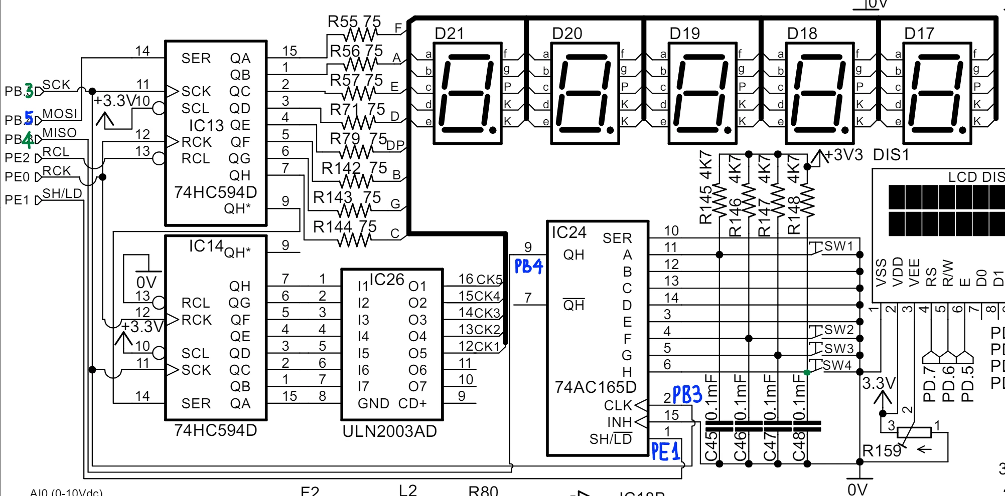

it's been week since I stuck on this problem, I have a board like this Screenshot (74).png, SPI3 MOSI PB5 is connected to ic 74HC594s to drive LEDs, and MISO PB4 is connected to 74AC165D to get the four SW (buttons) for input purpose, and the PB3 for clock on both ICs. I have succeed in using SPI to output numbers on LEDs via 74HC594 so I known that the SPI was up and running correctly. Now with the 74HC165, the basic idea is similar to the 594, start the SPI, wait for it to complete, than get the data. Heres my code:

For some reason, SW2 button which is store in button_read_2 couldn't be detected, while when I press SW1 button it change both button_read_1 and button_read_2 and cause both of them to true.

1.When PL is low, the input at A to H is stored and then shifted out... you seems to be making GPIO->E1 high and then low.
2. Since you are reading only eight inputs, you can go for 8 bit data mode.
3. 74HC165 seems to be outputting D7 to D0, make sure you do the bit masking correctly.
4. Check the timing of E1 high low transition to meet the required minimum duration, else insert delay.
5.Check if your CPOL and CPHA is programmed correctly based on the timing diagram of 165.
