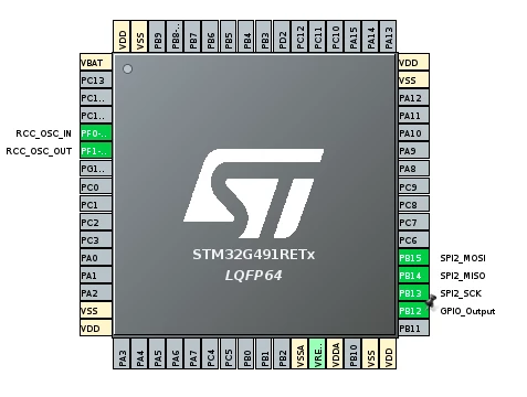

Hi Community, I recently worked on SPI in mode 1 and observed some miscellaneous behavior. Can anyone please confirm the configurations made to work with mode 1 are proper?
And when I use Hardware NSS Signal to Hardware NSS Output Signal there is no proper signaling (high at idle low when sending data) on SPI2_NSS even after setting pull-up in the GPIO Settings. So setting it up as GPIO_Output and controlling manually.

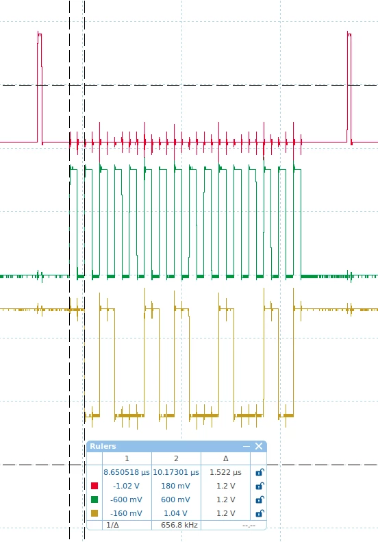

Please find the captured signal
Signal definition:
SignalPurpose
RedNSS (Controlled manually)
GreenSCK
BrownMOSI
The captured signal is wrong. The first data bit from the left should be 0 but is 1. In mode 1 raising edge of the SCK should alter the data bit and in falling edge should latch it.

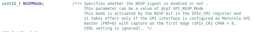

It is mentioned in the stm32g4xx_hal_spi.h that SPI_NSS signal will be enabled only if CPHA = 0. But in my case, it is 1. So why can't NSS isn't going to work in this case?

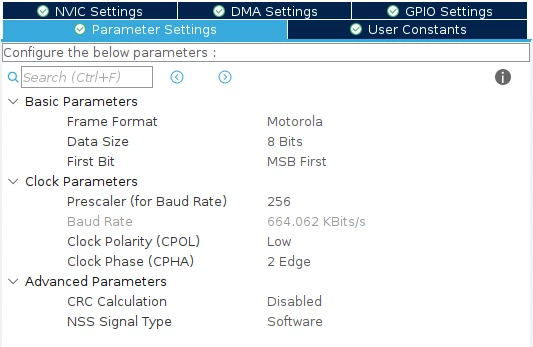

Hi @bruce_wayne_1997 the following configuration worked well for me with AD5592 SPI on CubeMX.
Data Size8 Bits
CPOLLOW
CPHA2 Edge
Use HAL_SPI_TransmitReceive and probe the SPI on the oscilloscope/analyzer.
In my case, as the data sent to AD5592 is 16 bits in MSB first order, STM32 sends the MSB of the first byte 0x02 (rather than 0x18) in your case a swap between bytes is needed.
I hope this helps!!!
Visitor II
April 25, 2024
Hey @newbie_stm32 ,
I changed the cubemx configuration to CPOL=low;CPHA=2 Edge as I understood from your reply.

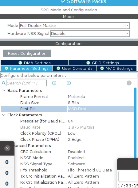

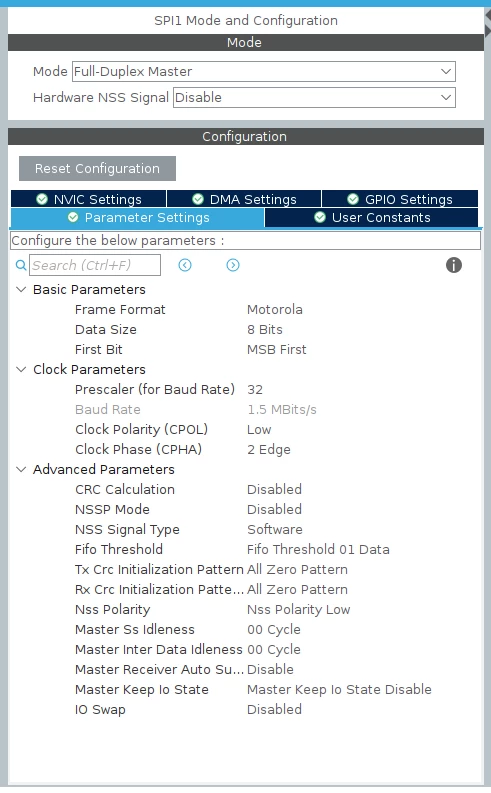

First I'd like to share my SPI configuration again: (Figure 1)

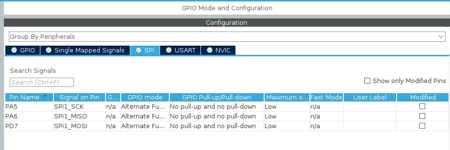

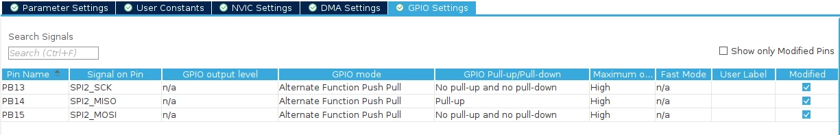

Sharing the SPI GPIO config: (Figure 2)

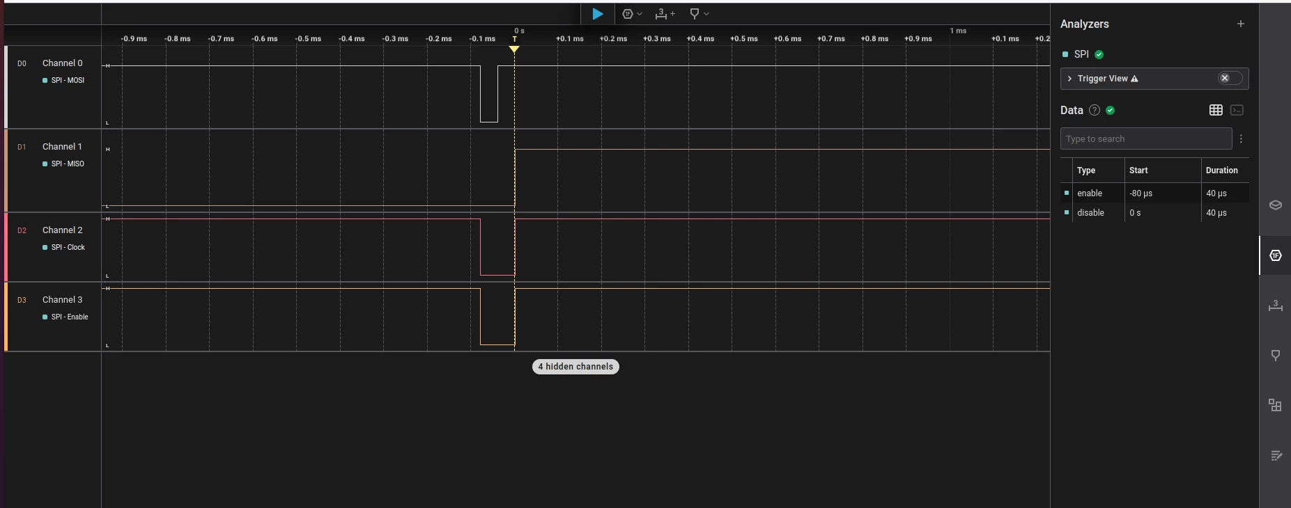

 I'm not able to receive anything on spi_rx_buf[2]. I concluded this using debug mode after line 27 from the code above. I believe this is happening because my SPI on the STM is not working properly - the SCLK line.
Sharing the Oscilloscope data: (oscilloscope is 24MHz, 8ch): (Figure 3)
 As you can see, the clock line is only changing once, the SPI data is not being transferred to the slave.
Sharing the SPI initialization code generated by Device configurator: (Code 2)
SPI Config: SPI Mode 1 (CPOL=0;CPHA=1), 8 bits, MSB first
static void MX_SPI1_Init(void)
 /* USER CODE BEGIN SPI1_Init 0 */
 /* USER CODE END SPI1_Init 0 */
 /* USER CODE BEGIN SPI1_Init 1 */
 /* USER CODE END SPI1_Init 1 */
 /* SPI1 parameter configuration*/
 hspi1.Instance = SPI1;
 hspi1.Init.Mode = SPI_MODE_MASTER;
 hspi1.Init.Direction = SPI_DIRECTION_2LINES;
 hspi1.Init.DataSize = SPI_DATASIZE_8BIT;
 hspi1.Init.CLKPolarity = SPI_POLARITY_LOW;
 hspi1.Init.CLKPhase = SPI_PHASE_2EDGE;
 hspi1.Init.NSS = SPI_NSS_SOFT;
 hspi1.Init.BaudRatePrescaler = SPI_BAUDRATEPRESCALER_32;
 hspi1.Init.FirstBit = SPI_FIRSTBIT_MSB;
 hspi1.Init.TIMode = SPI_TIMODE_DISABLE;
 hspi1.Init.CRCCalculation = SPI_CRCCALCULATION_DISABLE;
 hspi1.Init.CRCPolynomial = 0x0;
 hspi1.Init.NSSPMode = SPI_NSS_PULSE_DISABLE;
 hspi1.Init.NSSPolarity = SPI_NSS_POLARITY_LOW;
 hspi1.Init.FifoThreshold = SPI_FIFO_THRESHOLD_01DATA;
 hspi1.Init.TxCRCInitializationPattern = SPI_CRC_INITIALIZATION_ALL_ZERO_PATTERN;
 hspi1.Init.RxCRCInitializationPattern = SPI_CRC_INITIALIZATION_ALL_ZERO_PATTERN;
 hspi1.Init.MasterSSIdleness = SPI_MASTER_SS_IDLENESS_00CYCLE;
 hspi1.Init.MasterInterDataIdleness = SPI_MASTER_INTERDATA_IDLENESS_00CYCLE;
 hspi1.Init.MasterReceiverAutoSusp = SPI_MASTER_RX_AUTOSUSP_DISABLE;
 hspi1.Init.MasterKeepIOState = SPI_MASTER_KEEP_IO_STATE_DISABLE;
 hspi1.Init.IOSwap = SPI_IO_SWAP_DISABLE;
 if (HAL_SPI_Init(&hspi1) != HAL_OK)
 Error_Handler();
 /* USER CODE BEGIN SPI1_Init 2 */
 /* USER CODE END SPI1_Init 2 */
I'm just not able to figure out why SPI is not working. I have tried using other SPI peripherals like SPI_4 instead of SPI_1 and it is still the same. I also tried pulling down the SCLK line but it outputs the same waveform as shown above in Figure 3. Can the experts please suggest me how I can go about this problem? Now I'm sure that this problem is not a problem of slave but infact the master's SPI initialization itself. I'm using STM32H723 Nucleo board. Request STM experts to share their thoughts.

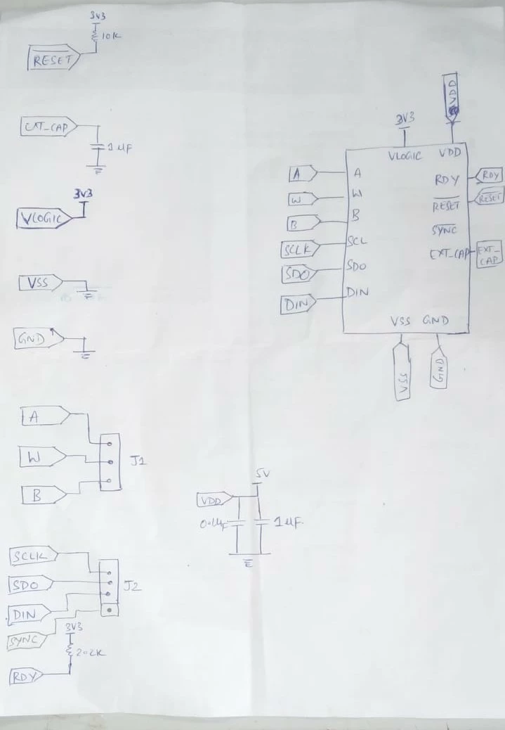

Although the slave is not the problem I'd like to share the schematics of AD5293 circuit I made for more clarity.
Is this correct?
