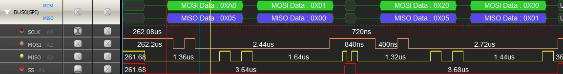

The evaluation kit includes a USB dongle with its own GUI interface, which I used to capture the waveform.
My SPI is clocked at 2.5 MHz, and the IC supports speeds up to 12 MHz."

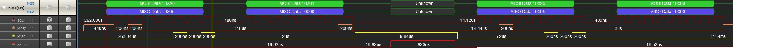

Communication with Nucleo G474RE (Getting input status but unresponsive to commands)@2.5Mhz
Communication data with evaluation kit usb dongle (which works perfectly fine)@5Mhz

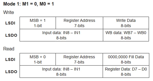

As per the datasheet this is my read and write packet structure
according to led matrix register iam trying to setl led at index 0 and in the frame 2 iam trying to readback the status

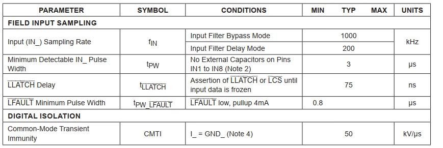

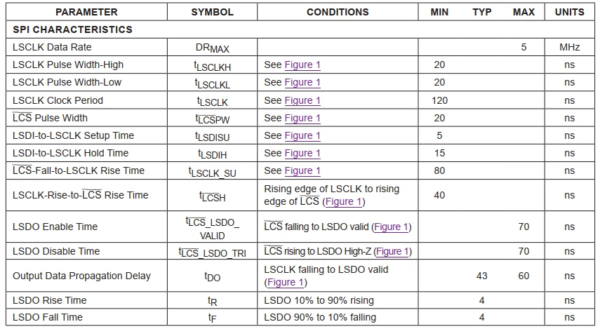

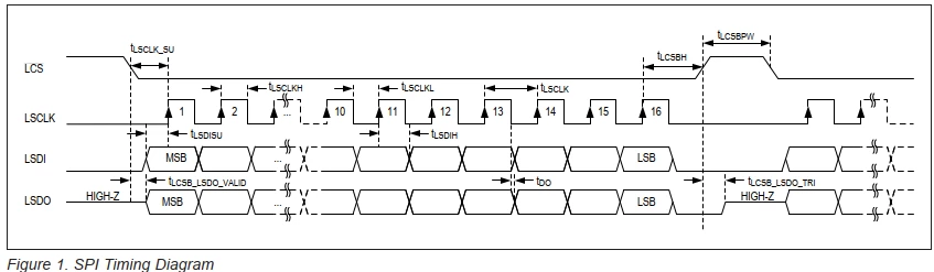

Am I missing something related to timing, these are the timing data given in the max22192 data sheet
