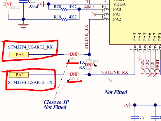

Hi, I am trying to access the Virtual COM port on my STM32F411 VET discovery board but I am not able to find the instructions to do so. I am trying to use serial communication in Simulink where for the STM32F4xx they used the USART2 and VCP com number from device manager. I have two doubts as the user manual is pretty confusing,
1) do i need to make any soldering or changed on the board or change the jumpers to activate the Virtual COM Port.
2) which cable does Vitual com port connect to? the mini USB port or the USB TTL cable, if USB TTL then what pins?
3) I am trying to access data from the MEMs accelerometer, will the USART be the same for this as well since there is only one USART for serial communication on the board? if yes, which USART?

This board? https://www.st.com/en/evaluation-tools/32f411ediscovery.html
This is an older board that doesn't have the VCP functionality with modification, but you can close SB10 and SB11 to get it. Then, it will be available on USART2 (PA2/PA3).
The VCP would be available on the same USB connector as the st-link (CN1).

I don't think so. According to UM and also the schematics even for rev.D, the STLink is V2 (STM32F103C8T6), i.e. not V2-1, i.e. it does not have VCP.

> How can i access a COM port in that case?
You can't. You need either some external USB-to-UART converter, or some different board (e.g. Nucleo) which does have the newer STLinkV2-1, which supports VCP.
