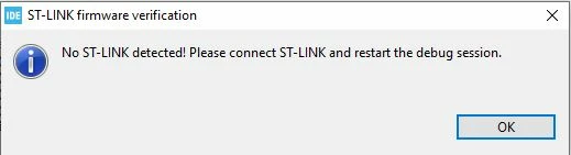

[Solved] Hi, I'm working with STM32F103C8T6. When I try to debug, it appers the window "No ST-LinkDetected! Please connect ST-Link and restart the debug session". I tried to modify debug configuration, but I can't debug my project. Can you help me?

Does the ST-LINK show up in Device Manager? Get the Windows Ding-**** sounds when inserted/removed?
Try different cables, different ports.
Avoid hubs and docking stations.
Don't use charging cables.

I don't use charging cables or hubs or docking stations: I've connected directly the device to the USB port of my PC. I've already tried to connect the device to different port, but the problem persists-

Hi, I've tried to uninstall the old version and install STM32CubeIDE 1.5.0; I've installed all ST-LINK driver (I think!), and I've tried to update ST-LINK Firmware, but my problem persists. Have you got an idea?

Does the ST-LINK show up in Device Manager? I don't recall getting a yes/no answer on this.
Is this a laptop? DELL? Corporate?
Are there any policy settings preventing USB MSC being plugged in?
What ST-LINK do you have? Official one, boot-leg?

Vangelis Fortounas
December 5, 2020
this device does not contains STLink but communicates with USB-Serial portocol.
Debuging with USB_serial port is imposible.
It is posible to program MCU by using STM32CubeProgrammer in UART mode and pulling up BOOT0 pin (jumper).

The software doesn't recognize the device, the connection is possible only in OTA mode, and I can't update the firmware.
I have a question: when I use STM32CubeProgrammer, to program the device I need another programmer, or it's enough to connect the device to USB port?

Hello, I managed to solve my problem.
I've used a USB to Serial chip connected to MCU, BOOT0 connected to 3V3, and STM32CubeProgrammer in the UART mode; I've downloaded the .bin file of my project and I've programmed my device. Now it works correctly.
