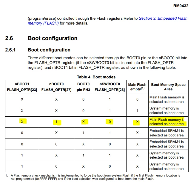

SMT32 L4 - Using pin BOOT0 as digital output
I am doing a pcb layout with a STM32L432KCU6 and using 100% of its 32 pins in my project. BOOT0 signal is on pin 31 on that MCU and in my schematic I have a digital output on that pin (PH3). There is no pull-down/up on BOOT0 on my design.
Programming will be via SWIO/SWCLK/SWO/RST/VCC/GND and I want it always boot from flash.
Is there any way to program the chip (write some config bits) to disable the use of pin BOOT0? How is that done?

Yes, take a look at the option bytes. Set nBOOT0=1, nSWBOOT0=0 to always boot from flash.
