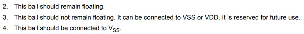

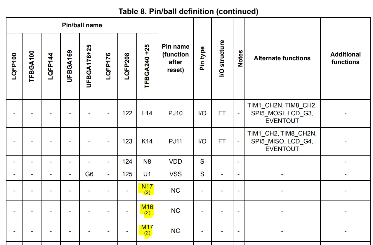

Should NC pins on STM32H753XI TFBGA240+25 be connected to ground?
Should NC pins on STM32H753XI TFBGA240+25 be connected to ground, or can they be left floating?
Thanks,
Thomas
TDKBest answer
May 27, 2020 3:13 AM UTC
It depends on the pin. Read the datasheet. Most should remain floating but some need connected to VSS or VDD.
