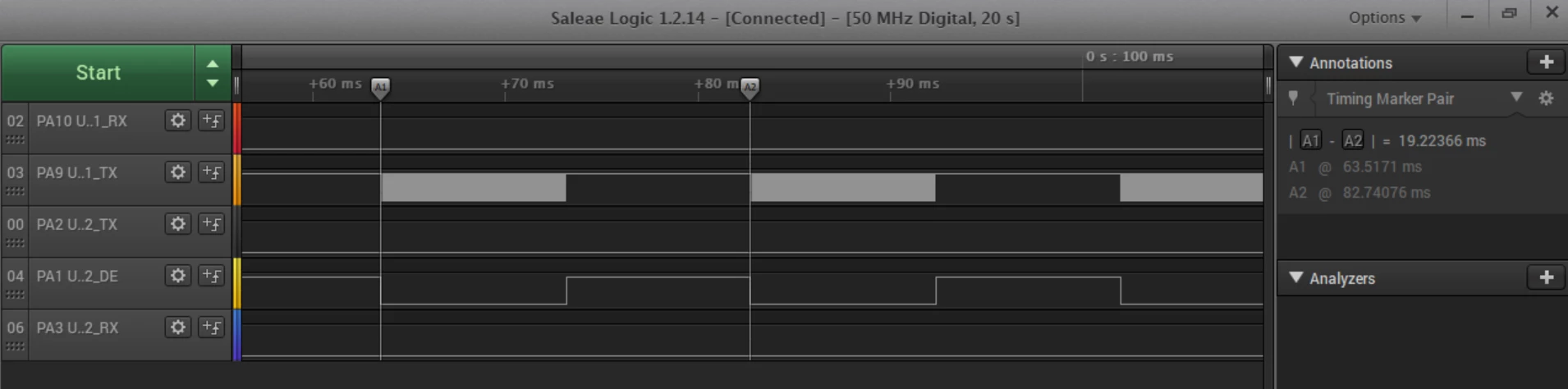

I'm running absolutely bog standard STM32CubeMx code on NUCLEO-F091RC to get RS485 working (NOPs added for debugging).
If I scope the USART2_TX line (PA2) I see no data.
There is data on the USART1_TX line (PA9) and the RS485 enable line (USART_DE PA1).
I've used digital analyser (image attached I hope) and standard oscilloscope but I see nothing.
The USART2_DE line stays set for 9.5ms so it makes me think it is doing something and stepping through the code it does put data into the USART Transmit Data register in HAL_UART_Transmit
huart->Instance->TDR = (*pData++ & (uint8_t)0xFFU
What blindingly obvious thing have I missed?

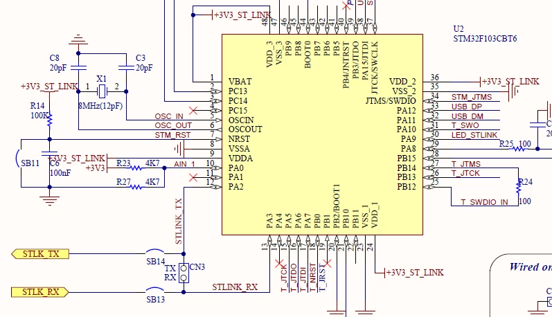

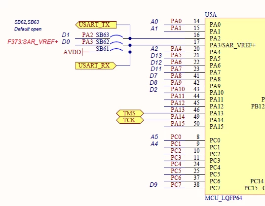

Looks like it is a feature of the NUCLEO-F091RC dev board.
Solder Bridges (SB63, SB62) not fitted to take PA2 and PA3 out to headers.
Solder Bridges (SB14, SB13) fitted to get debug serial through programming usb cable.
I can therefore either:-
  • fit SB63/SB62 and remove SB14/SB13 to get PA2/PA3 on external header
  • dig into HAL code to change standard pin selection to use other pins
Not fitted
Fitted
