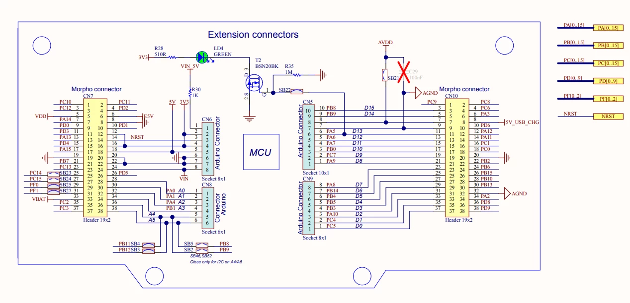

see >  under the "CAD Resources" tab.

While the pictures in UM2324 are labelled "Nucleo-G070RB", they should be identical with the 'G071RB Nucleo.
You can also check the schematics which is under the "CAD Resources" tab.

You Can take a look at the figure 17 of  the UM2324 to have an Idea about the STM32 Nucleo-64 boards ST morpho connector pinout. Than in the Appendix A you will have a description of the board I/O assignment. For details about the alternate functions ,Pin assignment and description, take a look at the tables 12 and 13 of DS12232 of the MCU STM32G071RB.
PS : For more details, you can also take a look at the Schematic Pack MB1360

Yes it's there in the schematic. Hat eating time
