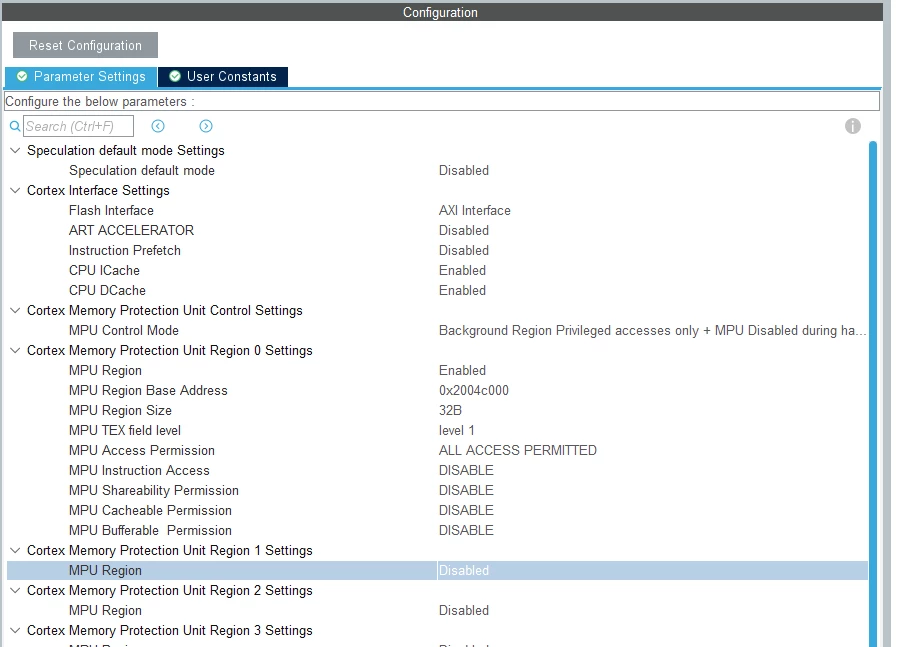

thanks for the answer, and the documentation, I checked and did exactly as described, since in other tabs it works.
I found out where the problem is... this micro is an M7 and it has the i cache and the dcache, if I disable these the semihosting works...
But unfortunately I need them because I use ethenet and LWIP, I configured the regions for ethernet (which works). But I don't know what I have to do for semihosting.
can you help me ?

Can only help if you explain method and show related code. Not clear why cache would be a specific issue.
DTCM shouldn't be an issue, not sure how USART would be either.​
Perhaps need to use memory fencing instructions or cache ByAddr maintenance. ​

Confirmed here, with STM32F767 on custom board similar to Discovery-STM32746G.
When D-Cache is NOT enabled, semihosting prints and file opens work well.
After D-Cache enabled, printf prints garbage, opening a file fails.
#include <unistd.h>
#include <fcntl.h>
#include <sys/stat.h>
#include <stdio.h>
extern void initialise_monitor_handles(void);
void test_semihosting(void)
 initialise_monitor_handles();
 //SCB_EnableDCache(); //<<< if this is commented, semihosting works
 SCB_EnableICache();
 __DSB();
 printf("Test semihosting! read big file from host\n");
 char const* fname = "F:/test/test.bin";
 int fd = open(fname, O_RDONLY|O_BINARY);
 if (fd <= 0) {
	 printf("Error open file!\n");
	 return;
 My program runs in RAM, if this matters (and there's another OpenOCD related bug...)
