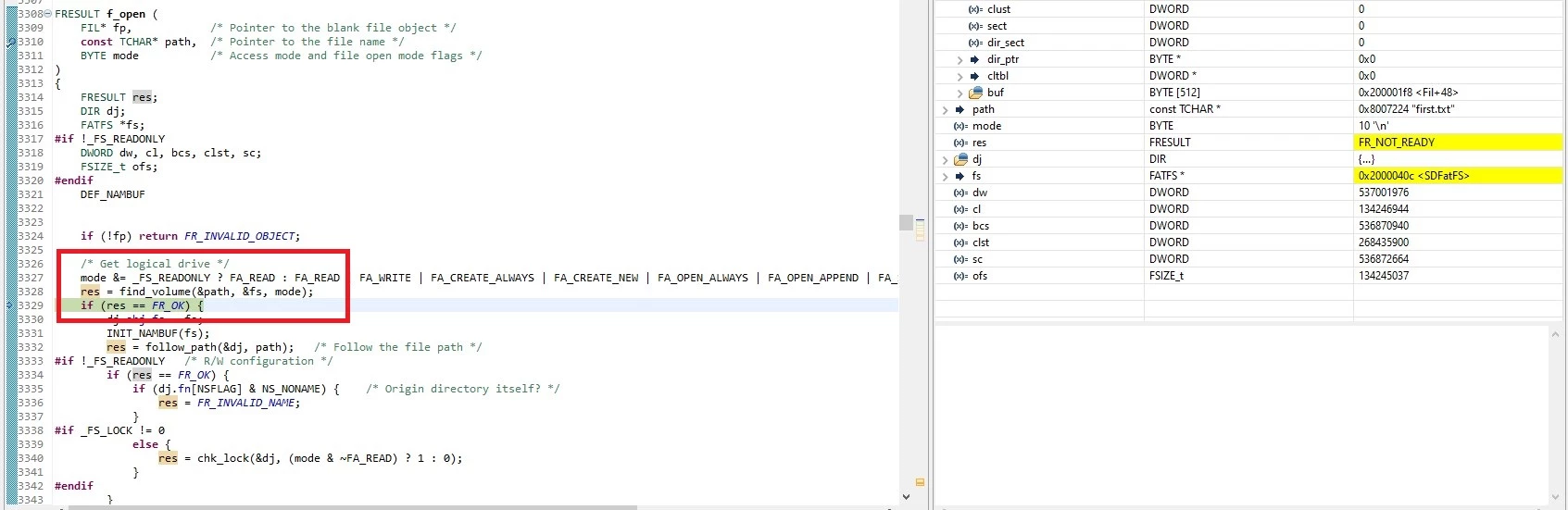

Hello, I am wanting to configure the SDIO peripheral on my STM32F407G-DISC1 to write a file to a 16GB type 10 micro SD memory. The problem is that I am receiving the FR_NOT_READY error when I want to create a file and I don't know what the problem is. I have attached my code.

 FR_Status =f_mount(&SDFatFS, "/", 0);// i prefer relative paths
 if (FR_Status == FR_OK)

	 FR_Status = f_open(&Fil, "first.txt", FA_WRITE | FA_CREATE_ALWAYS);// creates allways a file for writing. Root directory
	 if(FR_Status == FR_OK)

Yeah, probably not top level issue..
Need to get into the DISKIO and SDMMC layers, check if it' a comms issue, or that the GPIO for the card-detect is working.
efe_electronica
September 19, 2024
After reviewing, I found that the problem is generated when the find_volumen function is called, what is the cause?
