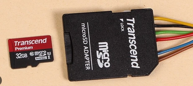

For testing just use a sd-card adapter with soldered wires; i always do it this way;
anyway wires should be max. 30 mm long;
