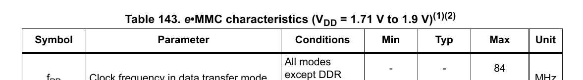

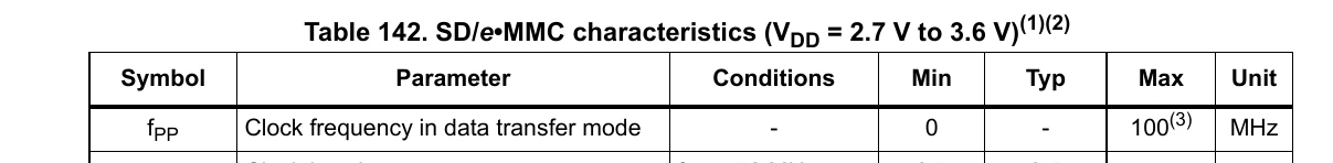

SD-cards only working on 3v3 supply (and signal levels - except switching to UHS mode later ).
from U575 ds:
so minimum for U575 seems 2v7 , and emmc can go with lower supply:
So just try with 3v3 supply: sd-interface working then ?
