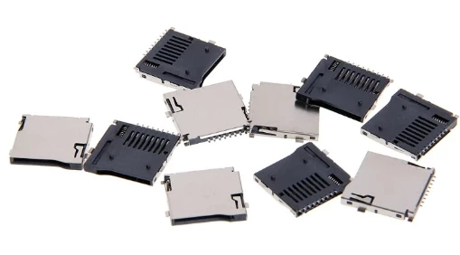

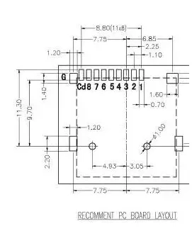

Here the card holder usually has a switch to case/gnd, so its easy to detect a card-is-in , ie with a pin+pullup connected to this switch. Other way is just send command -- and wait for response, or not.
Cd is this card-detect pin:

That is pin 1 on SD/miniSD and Pin 2 on micro.

Most sockets have a mechanical switch which grounds when a card is in the socket. It's rather rare for one to use the pull-up in the card itself, as again most sockets for SDIO/SDMMC need pull-ups for signal integrity with pins changing direction in 4-bit modes, and not using 1-bit modes beyond initialization.
