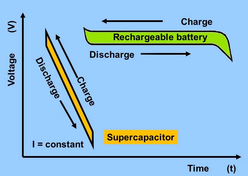

Andrew Neil
Dec 5, 2025 9:54 AM UTC
You haven't showed your schematic - see: How to write your question to maximize your chances to find a solution
Remember that Supercaps are not like batteries: the voltage decays gradually to zero - unlike batteries, which tend to keep a (relatively) steady voltage until they die:
#SuperCap #SuperCapVsBattery

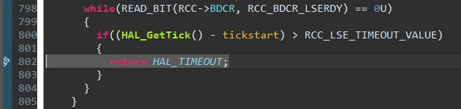

Dec 5, 2025 12:38 PM UTC
Hi everyone,
Here are a few additional details that I missed in my original post. The supercapacitor is connected directly to VBAT. Could this configuration cause any issues?
I am also facing a problem when I reconnect the main power for the second time on the STM32L4 series board. At that point, I encounter an LSE timeout issue.
Any insights or suggestions would be greatly appreciated. Thank you.

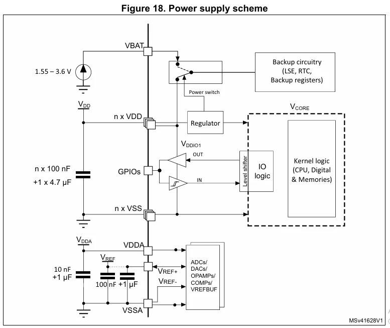

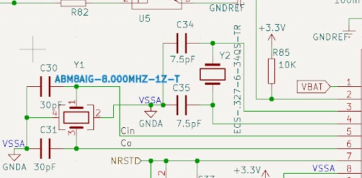

SourabhAuthor
Dec 10, 2025 7:36 AM UTC
Hi everyone,
Here is how my LSE and my supercapacitor is connected to VBAT.
SourabhAuthor
Dec 10, 2025 8:41 AM UTC
Hi everyone,
Andrew Neil
Dec 10, 2025 9:03 AM UTC
So this is your supercap: https://www.yageogroup.com/products/Capacitors/part/FC0V474ZFTBR24
You haven't shown how it gets charged, or how you manage the discharge.
Did I mention that Supercaps are not like batteries?
PS:
SO have you actually checked that Vbat at the STM32 remains within spec throughout the power-cycle ?
Does it work if you just fit a normal, primary battery?

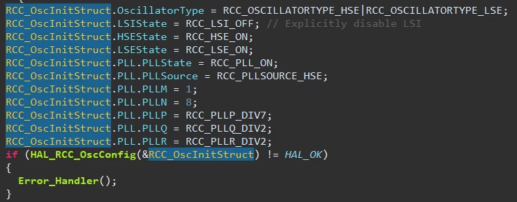

Dec 12, 2025 4:24 AM UTC
Thanks for the response,
By re-initialize, I simply mean the case where the supercapacitor is newly connected and I start a debug session to observe RTC/LSE running. At this point the LSE starts correctly.
Then I remove the main power so that the MCU switches to VBAT mode (supercap at ~3.0 V).
When I restore main power and start debugging again, the firmware tries to run HAL_RCC_OscConfig() and at this point the LSE no longer starts — it times out.
I am not intentionally reconfiguring LSE every time; I am only restarting the board to verify that RTC continues running. However, because the backup domain never lost VBAT, the LSE remains in a bad state, causing LSERDY to never assert.
So by “re-initialize,” I mean a normal power cycle for validation, not manually reconfiguring RTC. The issue is that after VBAT-only operation, LSE startup fails unless the backup domain is explicitly reset.
waclawek.jan
Dec 12, 2025 7:05 AM UTC
If you reset (by cycling its VDD, or otherwise) the mcu while valid voltage at VBAT is present all the time, LSE and RTC remains running. If not, there's some serious problem with the hardware, but you probably can't tell that just by looking at return value of a Cube/HAL function.
Why does HAL_RCC_OscConfig() perform in a different way than you expect I don't know, I don't use Cube/HAL; however, Cube/HAL is open source, so you can debug HAL_RCC_OscConfig() (single-step, observe variables' and relevant registers' content, etc.)  in the same way as you debug the rest of your code.
