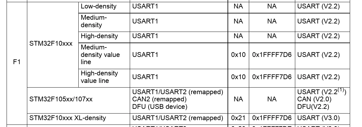

There is no driver. STM32F103 does not support USB boot, so you need either the debug interface (like ST-Link) to program the STM32F103 using SWD or some USB-UART module to use bootloader via PA9, PA10 pins.

So you want boot from direct USB connection on Blue Pill , with F103 cpu ?
I see small problem here: F103C8 or CB has no USB boot built in.
see AN2606:
-> can boot from usart1 connection - thats it.
