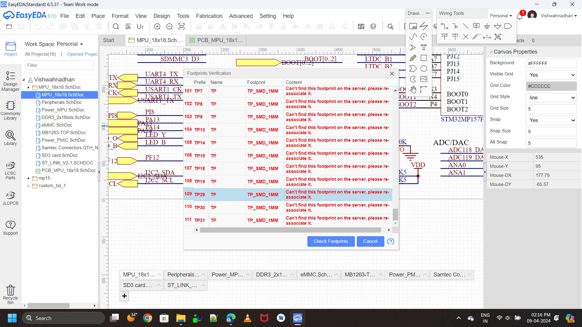

Dear ST-Electronics Community,
I hope this message finds you well. I've noticed a limited number of posts (1 or 2) regarding the import of Altium format files and the subsequent development of custom PCBs. Could any hardware professional from the ST-Community please look into this matter?.
I have access to Altium Designer and wish to import ST-design files into Altium for time-saving purposes. However, I'm unsure of the exact process and would appreciate guidance on how to proceed. I attempted to convert the SCHDOC.ASCCI format to import into EasyEDA, as I find EasyEDA easier to use for board design. However, I encountered a footprint missing error after importing into EasyEDA.
My question is, can I use Altium directly for converting the design to PCB after importing the design files? Will this method work, or is there a proper method to extract the schematic and convert it into a PCB?
I respect any suggestions or guidance you can provide me!
thankyou.

@jr_engr_mbed wrote:
My question is, can I use Altium directly for ....
Questions about the capabilities of Altium tools, and how to use them, are probably best directed to Altium:
https://www.altium.com/support
https://forum.live.altium.com

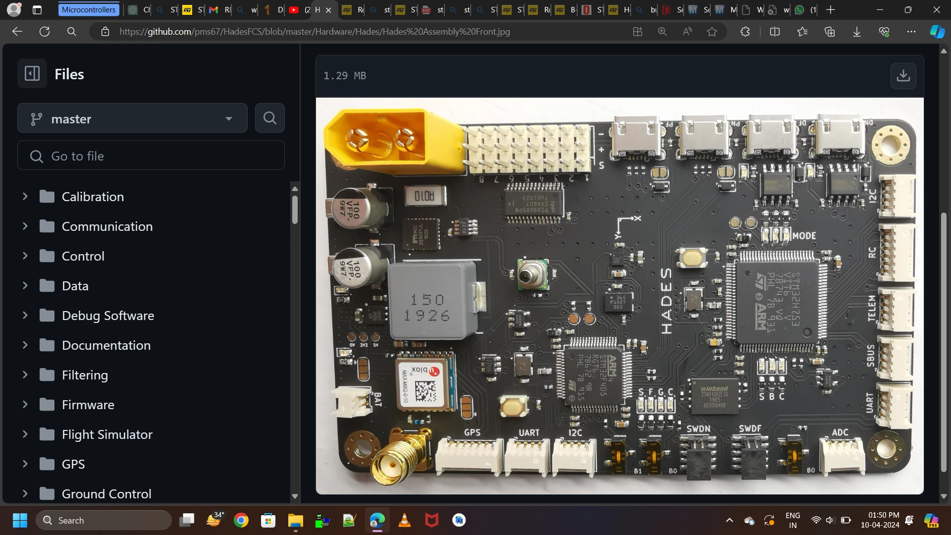

Hi Tesla, thank you for steering me away from a potential mismatch. Is it true that integrating a 1980x720 resolution display with an STM32 microcontroller presents challenges? Could this be due to limited SDRAM capacity? If that's the case, might a 10.3-inch display with a 1280x480 resolution be easier to manage? Also, does stm32h753 chip have the necessary libraries for GUI support? I've found a custom 4-lane TFT 1280x480 LVDS display from BuyDisplay.com. Would it be compatible with an STM32H753 MCU?
Regarding custom hardware, if I can integrate this display with TouchGFX without issues, then our end product will be ready. luckily,I've found an open-source H753+F405 board on GitHub. Is it a good idea to use this as a foundation to avoid starting from scratch? I believe importing this ready-made project is wise, considering I only need to modify the basic schematics to include the LVDS and a printer port.
If everything looks in order as you’ve assessed, please advise if I am moving in the right direction.
Thank you for your advice on the previous post. Without it, I might have been in deep trouble.
it's flight controller from phil's lab youtube:
Flight Control System Design: Hardware and PCB Design with KiCAD - Phil's Lab #1 (youtube.com)
