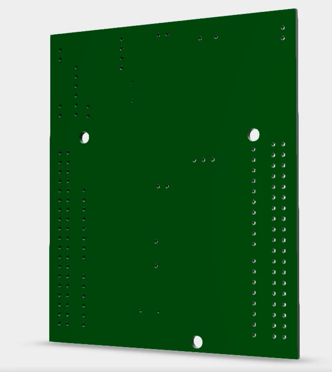

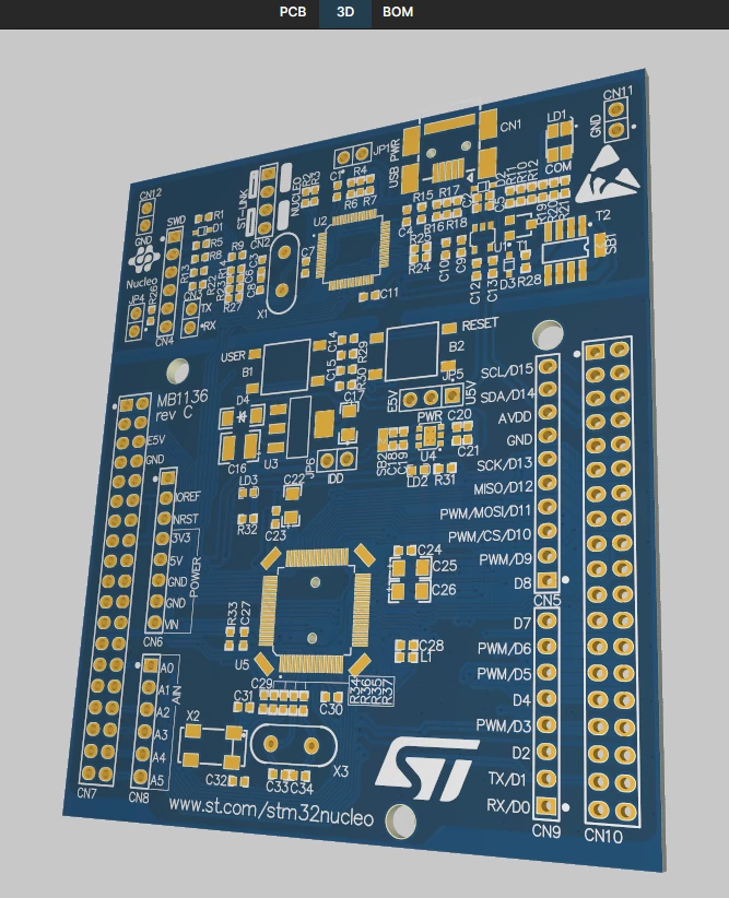

Karl YamashitaBest answer
Principal
Sep 5, 2026 9:03 AM UTC
Look at the Board design zip file. However the project is in Altium Designer. You’ll need an Altium account which is free so you can view the pcb board. Then you can have it export the pcb as a step file for your CAD program.
Altium Viewer
I’m using Autodesk free account to view the step file. I’ve attached the step file as well.

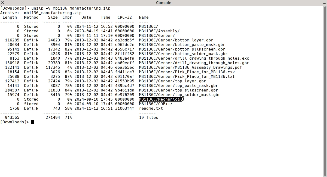

Sep 5, 2026 7:05 AM UTC
Thank you Karl, for providing that link.
Checking for manufacturing files, I found this :
https://www.st.com/resource/en/board_manufacturing_specification/mb1136_manufacturing.zip
However no mechanical resources are available inside the archive.
screen-capture of mb1136_manufacturing.zip contents
