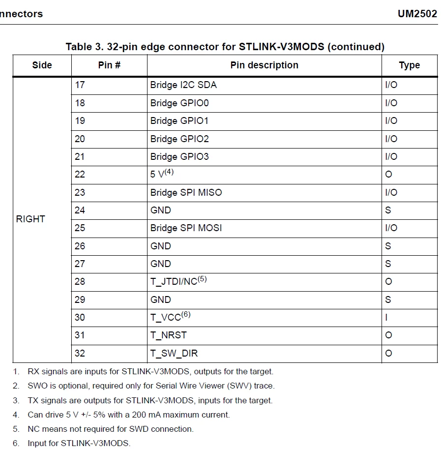

Regarding +5V Pin on STLINK-V3MODS
This question pertains to the (relatively) new STLINK-V3MODS programming/debugging device.
The UM2502 Users Manual for this product goes into great detail about using Pin #22 of the castellated edge connector aka +5V for ancillary purposes:
"Pin 22 of the right edge pin connector can drive a 5 V target with a maximum output current
of 200 mA. The 5 V pin is guaranteed to be in the +/- 5% range if the driven current does not
exceed 200 mA."
I attached an ohmmeter between pin #22 and the board's +VBUS pin on its USB connector. Because +5V power from pin #22 would be derived from +VBUS pin I expected to see near zero ohms between these nodes. However, I did not and I'm curious why not.
Is there a microcontroller-enabled pass transistor between +VBUS and pin #22? When is this transistor enabled?

Mike_ST
Apr 19, 2023 12:56 PM UTC
Yes, there is a power switch between the 5V coming from the USB port and the pin #22.
I don't have the exact details, but the ST-Link V3 firmware decides when to enable it.
Most of the time, it should be ON.
The LD3 green LED will be OFF if the power switch is not enabled.

Nov 5, 2024 4:44 PM UTC
The ST-Link firmware is expected to automatically activate the 5V output when conditions are met for that; typically, in case no signal is present on pin22 at ST-Link startup, when the USB enumeration is completed by the host. This is because the ST-Link (as any USB device) is not expected to consume too much current on the USB in the early phase of enumeration. In case a signal is present (high level) on pin22 at ST-Link startup, the firmware assumes the target is externally powered so it does not activate the power switch at its level. Note that this behavior applies since version V3J6M2; in case of older version please upgrade your V3MODS with STSW-LINK007 - ST-LINK, ST-LINK/V2, ST-LINK/V2-1, STLINK-V3 boards firmware upgrade - STMicroelectronics.
Note that afterwards, in case of target powered by the ST-Link, the ST-Link disables the target power during firmware upgrade.
Currently I don't understand how it could be possible to have no power on pin22 but LD3 ON. Do you have the possibility to check the pin22 signal level ?
