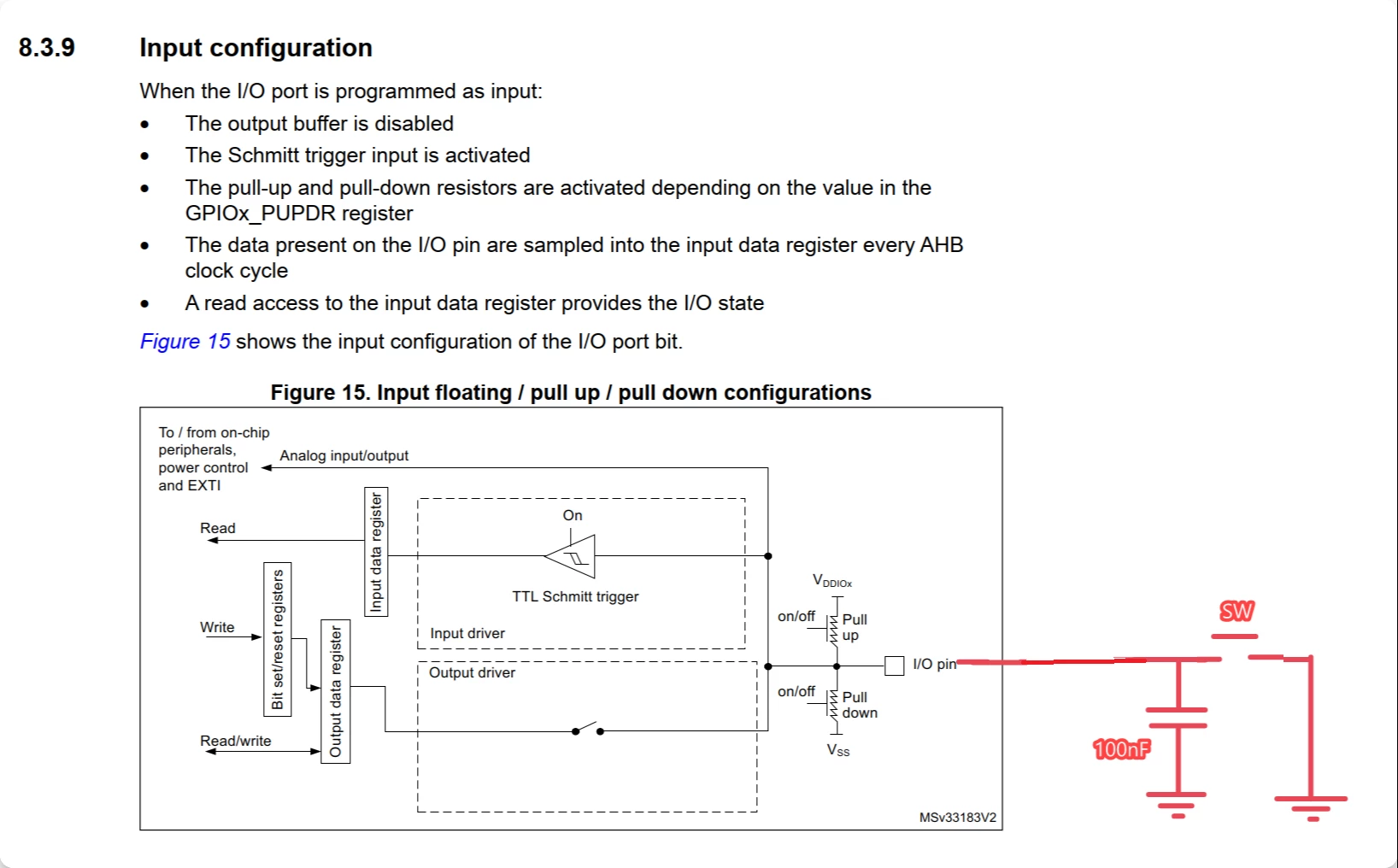

Hello, I am desiging PCB with STM32F030Fx where I plan to use blocks of 5 push buttons for reading user inputs.
For the most of  tutorials, they use reading ACTIVE HIGH after the press, but I thought more common is to read ACTIVE LOW.
Also there is internal pull-up ressistors according to the schemtaic, so probably not necessary to use external pull-up resitstor for it.
Using 100nF capacitors should simplify debounce process.
Is it reliable for readings?

That will work just fine. The time constant will be 40kOhm*100nF = 4 ms which is sufficient for debouncing. You can use either active high or active low. They both work.
Aug 11, 2026 1:46 PM UTC
How did you identify 40kOhm values?
Aug 11, 2026 1:50 PM UTC
Check the datasheet for the nominal value of the internal pullup/pulldown.

Yes, active-low with the STM32 internal pull-up is a perfectly reliable approach. Ensure the input is configured correctly and the 100 nF capacitor doesn’t make the RC time constant too slow. A small software debounce is still recommended for clean button readings.
It really makes no difference: you just check whether the value at the pin is the ‘open’ or ‘closed’ value.
Make your code easily adaptable to either case with something like
