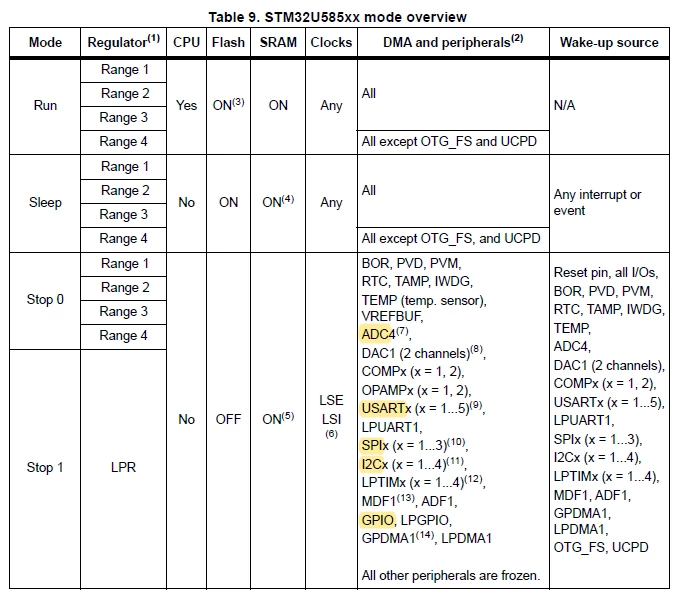

As per datasheet of stm32u5 series during the Stop 1 mode DMA and peripherals are accessible. When tried to access the GPIO read. Controller during debug mode reading the GPIO, but in the run mode the GPIO is not getting read. How to read GPIO pin in App_ThreadX_LowPower_Enter. Based on reading the pin I'm triggering EXTI SWIER interrupt to wake up from Stop 1 mode.

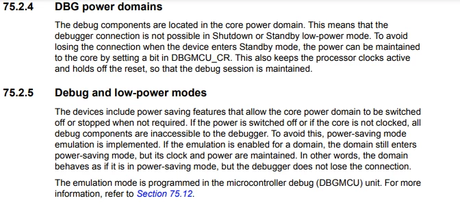

My first question is did you make sure that you still have your debug access available even in stop mode?
Because if you read the RM you will see that if not configured correctly you lose access to your debug in STOP mode.

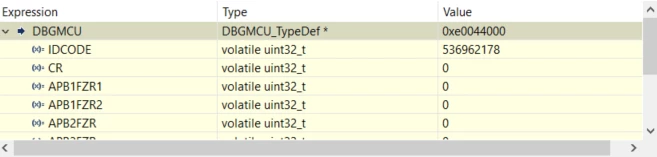

The DBGMCU->CR register is not set
Still I could able to Debug in stop 1 mode without any issue.

Did you do the test with the DBGMCU->CR set ?
