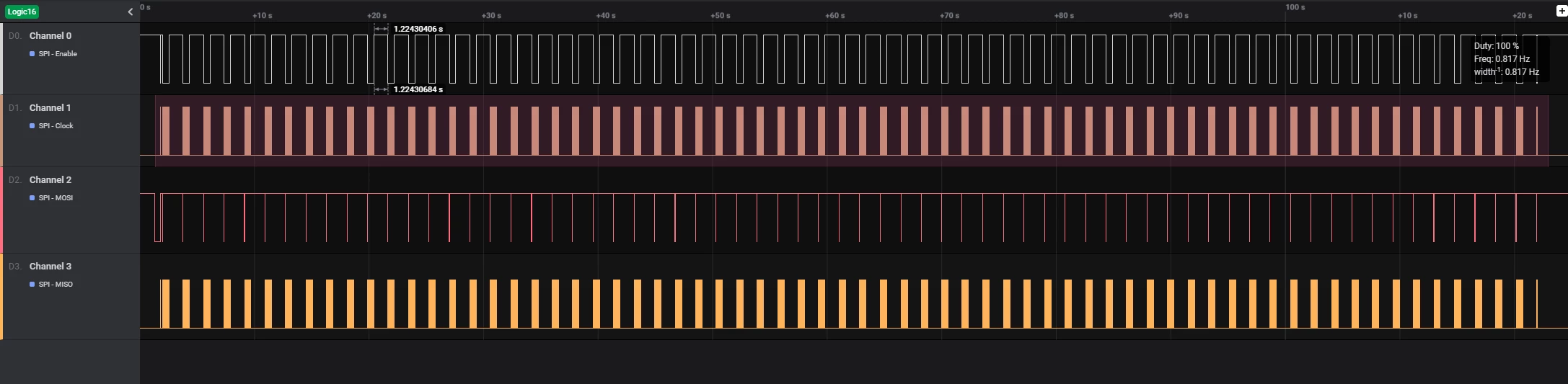

I measured with the Logic Analyzer. Thats the result:
The most time is lost between two 500kB chunks (>1.2s). The transfertime of one 500kB chunk is less than 0.6s. For 32MB it tooks about 2min to transfer.
@Khouloud GARSI​ : Is there a possibility to reduce the time between the 500kB chunks?

I also tested the CLI with a Nucleo-L432KC and a QuadSPI flash memory.
I was wondering why @Marco.R​ you had to do a dummy read beforehand but the CLI would not do a full read without it (it would stop after the first chunk). @Khouloud GARSI​ is this a known issue ?
In my case it takes 2min and 25s to read 16M in one go. The transfer is divided in chunks of 43520 bytes (my device has only 64k of SRAM), with a delay of approx. 300ms in between.
I believe the difference of delays is due to the size of the chunks and the time it take for the ST-Link to retrieve them.
On a side note I see that Init flash loader is always called, even in between chunks. Is it really necessary ?
