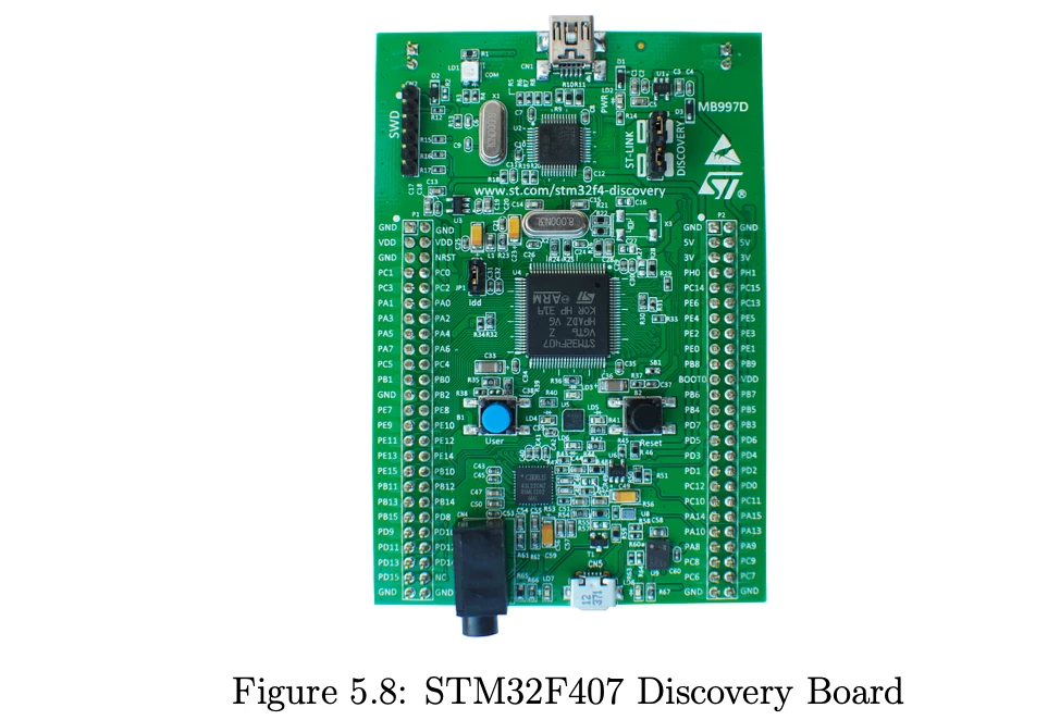

    So you bought an STM32f407-DISCO board, or Something Else?
    The DISCO board has an integrated ST-LINK that connects via the North End Mini USB cable, not the Micro USB on the South End.
    You need a suitable and working data cable for connectivity. The computer needs to find the attached USB Device and load the appropriate drivers so that applications can FIND IT.

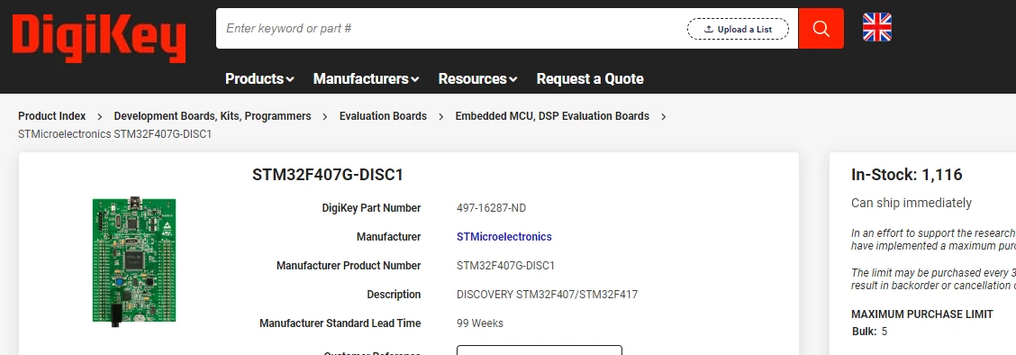

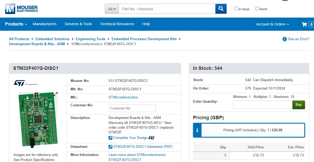

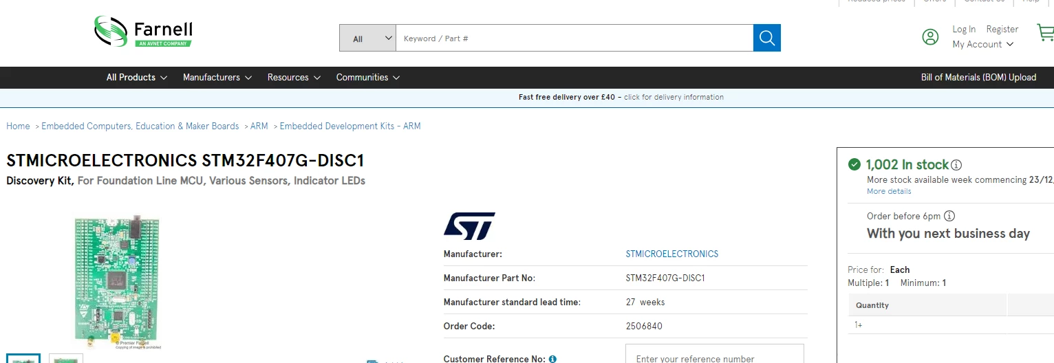

    What board?
    The STM32F407 DISCOVERY seems to be widely in stock:
