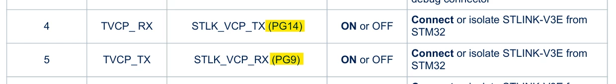

Hello everyone,
I am using the b-g4743-dpow1 discovery kit and I am trying to perform UART communication. However, the board does not output the UAR output to the computer. Currently, I can read the observe the UART output through oscilloscope, the output is just not shown on serial port utility on pc. May I ask how should I connect the board to pc (USB, Type-C? I am not sure how to connect) and is there anyway I can solve the issue? Thanks a lot

UART/VCP connections are on PG14/PG9. Are those the pins you are using?
Make sure you are opening the correct COM port, and that baud rate and other settings are consistent.

If you do not use a UART-USB converter and want to communicate with the PC via USART3, this is realised via the embedded ST-LINK/V3. The ST-LINK/V3 can be accessed via the micro-USB socket.
The USB-C socket is for direct access to the USB port of the STM32G474RE and for UCPD communication.
Hope that helps?

and if you are using a USB-Serial cable, make sure you connect RX pin cable to TX pin of board and vice versa.
