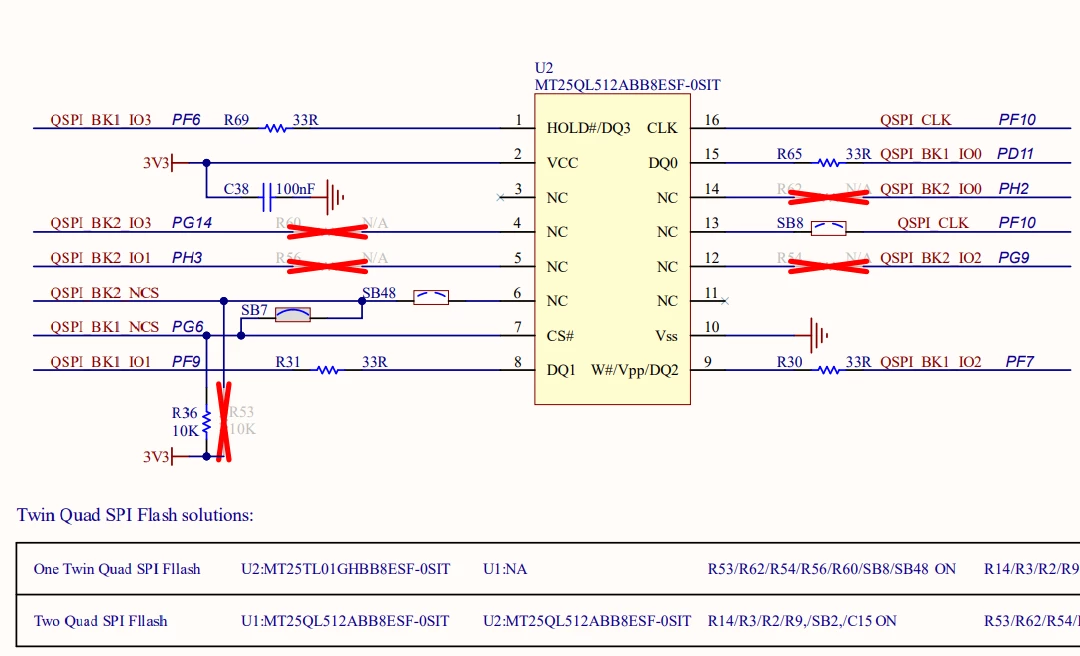

Dear @YCF.1​  (Community Member)​
Please double check if you're not in the case of the errata "2.4.4 Memory-mapped read of last memory byte fails". If yes, please configure FSIZE the double size of the real size of your memory.

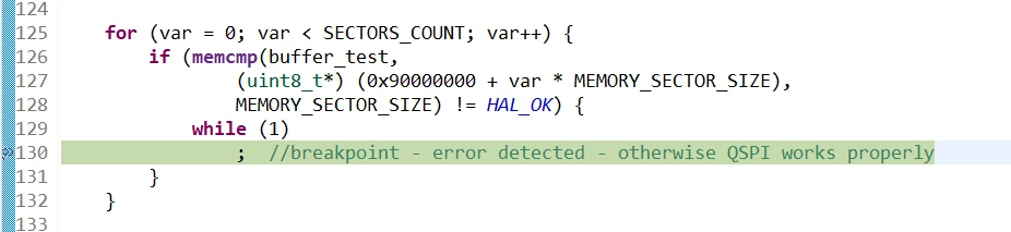

The issue may be memory ​mapped fail, because I try to
memcmp(buffer_test,(uint8_t*) (0x90000000 + var * MEMORY_SECTOR_SIZE),1) still fail.

The memory mapping needs to be working
https://github.com/WellinZHANG/External_Loader/blob/main/QSPI%20testing/main_test.c#L36

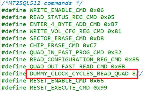

If it's already failing at the first byte then perhaps the command/template is wrong.
Check dummy cycles, command format, etc.
