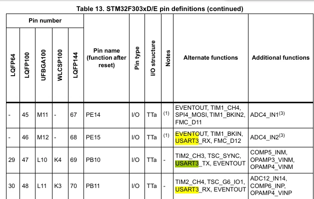

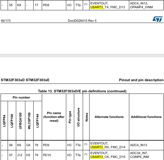

I noticed that PB10 and PE15 were automatically configured by STM32CubeIDE when I enabled the USART during configuration. I saw in the datasheet that multiple pins are associated with each U(S)ART, but I’m struggling to understand how to determine which pins to use and when.
The IDE automatically assigns pins linked to a specific register, but I’d like to understand the logic or criteria behind this process. How am I suppose to know that USART is attached to PD8 and PD9 while the IDE enabled the other pins? I’ve attached some images from one datasheet for your reference.

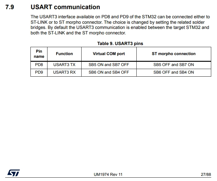

Is the the NUCLEO-F303RE board? Are you trying to use the ST-Link's VCP? The VCP is connected to USART3 over PD8/PD9 by default.

The pins associated with UART3 VCP are PD8 and PD9. However, in your IOC file, you have configured PB10 and PE15 instead.

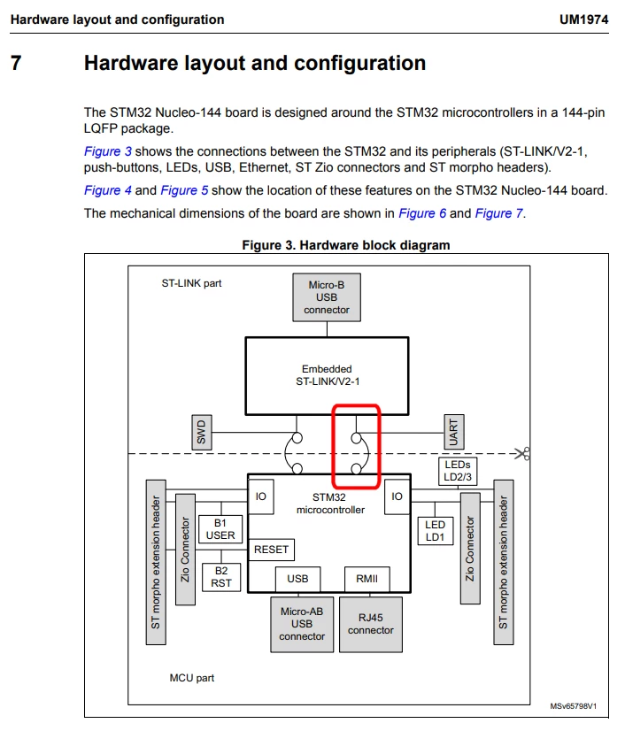

Andrew Neil
Oct 27, 2025 2:52 PM UTC
@Athandile wrote:
I'm not sure about the UART that support VCP in STM32F303ZE microcontrollers.
The UART itself doesn't have anything to do with VCP - it's just a UART.
The VCP is part of the ST-Link on the Nucleo board.
The Nucleo board provides the physical connection from the STM32F303ZE microcontroller to the VCP in the ST-Link:
Details of which UART and which pins are used:
https://www.st.com/resource/en/user_manual/um1974-stm32-nucleo144-boards-mb1137-stmicroelectronics.pdf#page=27
via: https://www.st.com/en/evaluation-tools/nucleo-f303ze.html#documentation
