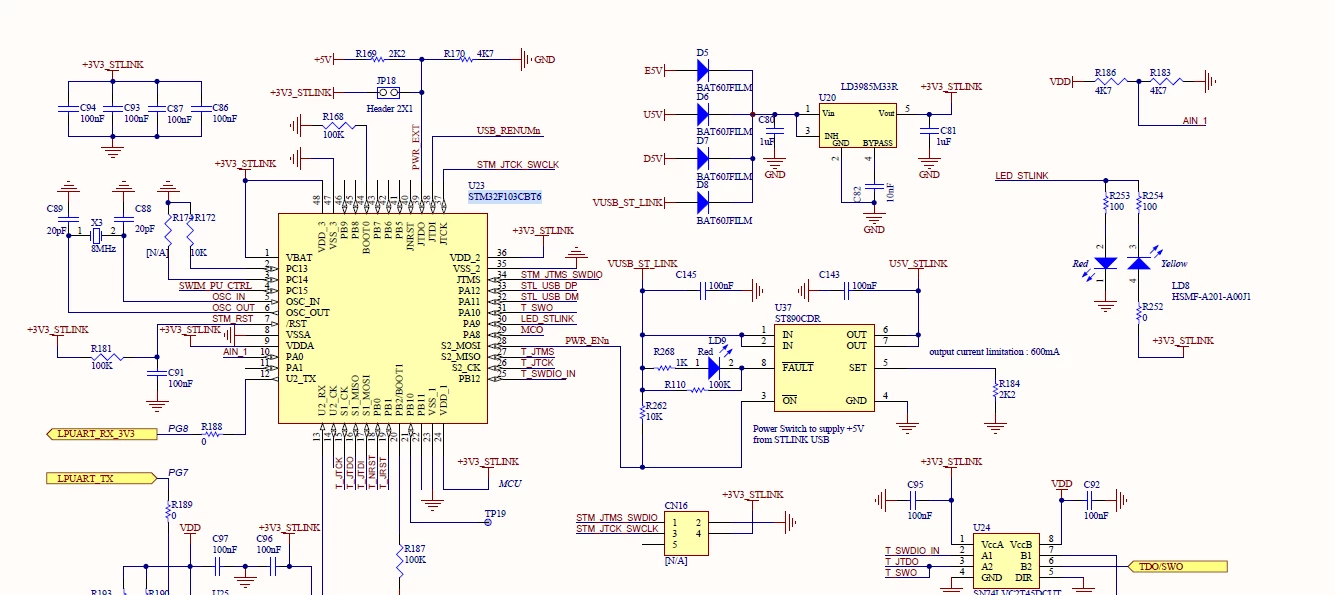

Hi everyone,
I’ve noticed that many STM32 development boards include two microcontrollers: a main controller and an additional smaller-range controller. For example, I have the STM32L476 Evaluation Board, which features the STM32F103CBT6 as the secondary microcontroller.
I’m curious about the purpose of this secondary microcontroller. Does it serve a specific function that cannot be achieved without it? Additionally, could the board still function effectively without this secondary controller?
For reference, I’ve attached the schematic of the board to help clarify my question.
Thanks in advance for your insights!

This is the onboard STLINK-V2 module (STM32F103) to program/debug the target MCU (STM32L476).
You need to read the title of each schematics sheet at the bottom left corner:
Hope that answers your question.

Andrew Neil
Dec 20, 2024 11:41 AM UTC
Yes: as @mƎALLEm said, it is the ST-Link:
Yes - but you would then need a separate, external ST-Link (or equivalent) to program, debug, and provide VCP.

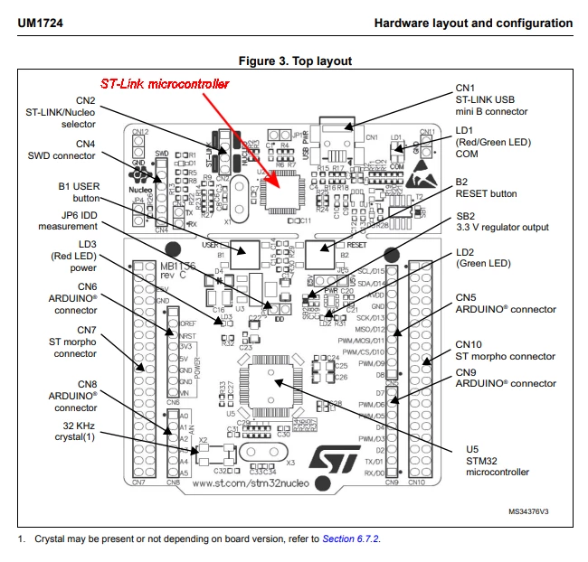

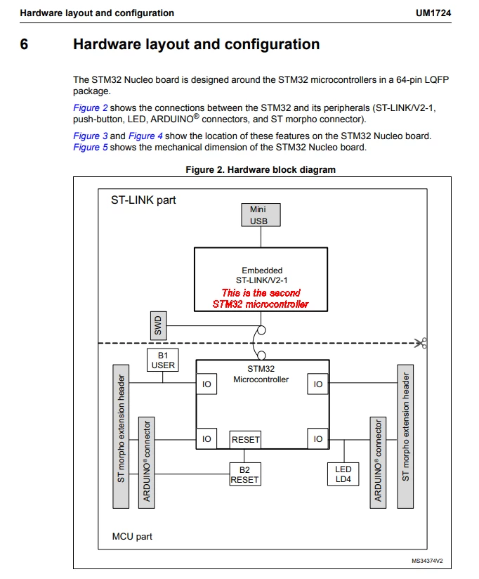

In fact, the Nucleo-64 boards (as shown above) are specifically designed so that you can snap-off the ST-Link part!
PS:
Note that this practice of providing an on-board debugger is now standard throughout the industry - it's not just ST (in fact, ST were rather late to this particular party).
Naturally, manufacturers will tend to use a chip of their own to provide this feature; eg, Atmel (now Microchip) used an AVR; TI will use a TI chip; NXP use an NXP chip; etc, etc.
