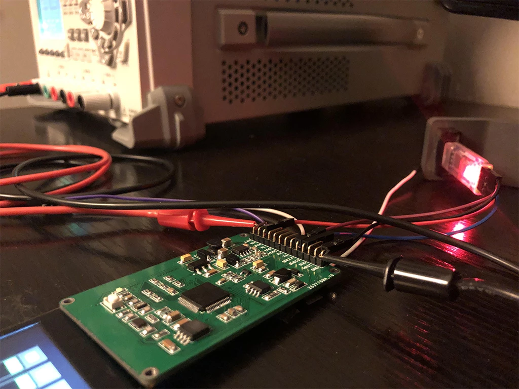

Sure. Not much going on in all honesty other than;
1) External pwr (24V to 5V) Step-down feeding a LDO (3V3)
2) PC/Programmer connecting to 3V3, SWCLK, SWDIO, GND0693W000000WnmDQAS.jpg

I was confused as well when designing a board for an F730, so i made connections for all 8 signals to/from an stlink2. I don't think the jtag stuff is needed, so i think you just need swd, power and ground so 5 signals/pins. The power connection to the stlink is not for powering anything but rather is used by the stlink to detect the correct voltage for interacting with the target.​

Tried connecting SWCLK, SWDIO, GND and leaving 3V3 disconnected and that didn't worked out. Still getting current going to the programmer. Tried a diode on the prog GND to prevent that and that didn't do anything.

Dunno. The stlink is powered thru the usb and the target board should be powered separately. The Vcc connection between the two is for sensing on the stlink. I've had no trouble using stlink with multiple boards using 8 pogo pins to connect to pads on the f730 target board.​

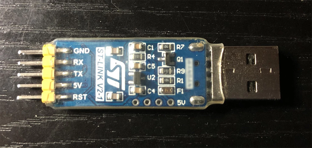

I have a feeling what you are trying to say is that the programmer I am using might/could be the issue ;) Attached is what I was given by the IC supplier, told me this is all what I needed to get balls rolling. Do I need to get myself an official ST-LINK V3 or similar to get External Power to work with PC/USB?
Given I might use the same SW interface on the official prog (i.e. SWCLK, SWDIO, 3V3, GND), would the end result (fault?) not be the same as this V2.1?

The ST-Link programmer you have is not an official programmer. It's an even lower cost knock-off. But it probably works fine. I don't know if the 3V3 on your programmer is intended to power the board. I suspect it is. Whereas in the official programmers, the board needs to be self-powered. This is an important difference.
Try to only connect GND, SWDIO, and SWCLK. Official programmers also connect NRST but it is not strictly needed.

Fair enough. Should have posted that '3rd party' programmer I was using initially, my bad. I'll see if I can get my hands on a ULINKplus locally or if not I'll crack on and get that official ST-Link V3 bundle on order. ps. that little programmer's 3V3 output is indeed to power-on the board, my understanding anyway. They do emit a rather fancy strobe effect when powered + eternally! hrr:/

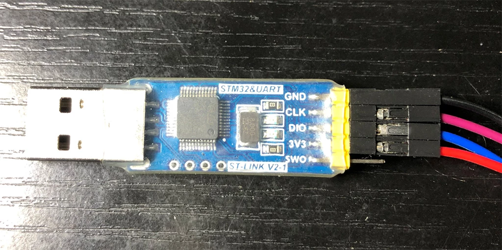

Here's its other side. It is supposedly The Best In The World programmer a fully loaded $3.49 can buy today. While at the supplier's shop and when asked; "Tool Me Up for STM32", I was given this only choice, quoting "you will never need more than that, it does it all" (lol) aka the SWO option the supplier referenced, I believe.
Lesson learnt; let me get this fixed up right away, I'll order the right kit for the job(s). Thanks for pointing me in the right direction.
I highly doubt that, as it's only voltage regulator is U2, which is not be able to provide any decent amount of spare current for an additional board.

Ah those micro SOT-23 LDOs! Good for up to 250mA, the Chinese claims they are good for up to 5A if you buy 50,000 reels, ofc (jjk).
Served quite well at the breadboard stage to power up that prototype MCU, a debug LED and to start-up crystals type thing. It will also power up a 240X320 with 4x 20mA backlight LED without any significant temp change or anything major. Go figure. If only it could coexist an external supply it would be great but sadly that lil F1 poly stobes pretty quick when you do :\
