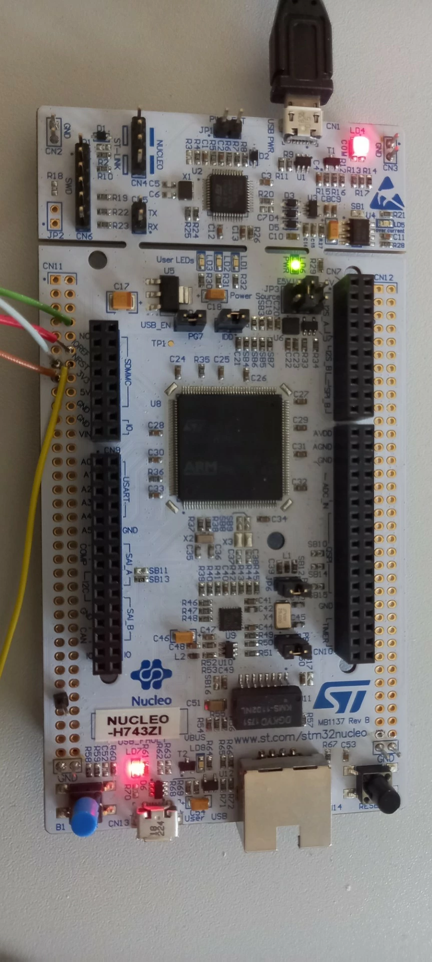

I have a stand alone ST-link/V2 and I need to use it to flash the FW to a STM32H743 Nucleo-144 "Nucleo-H743ZI"
I removed the two jumpers on CN4 to disconnect the on board ST-Link
and Connected the following Signals, the table show mapping from Nucleo CN11 pin
SignalNucleo CN11 Pin#ST-Link ICD20-Pin#
VDD12 - 3.3V1 - MCU VDD
GND8 - GND4 - GND
SWDIO13 - SWDIO7 - SWDIO
SWCLK15 - SWCLK9 - SWCLK
NRST14 - NRST15-NRSTOptional
the board is powred through CN1
The Programmer is connected but the target Volatage is not 3.3V
and when I try to connect I get this error

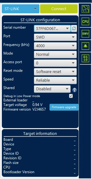

13:26:57 : STM32CubeProgrammer API v2.19.0 | Windows-64Bits
13:29:41:379 : UR connection mode is defined with the HWrst reset mode
13:29:41:518 : ST-LINK SN : 57FF6D067186535413301487
13:29:41:518 : ST-LINK FW : V2J46S7
13:29:41:518 : Board : --
13:29:41:518 : Voltage : 0.58V
13:29:41:519 : Error: Unable to get core ID
13:29:41:519 : Error: No STM32 target found! If your product embeds Debug Authentication, please perform a discovery using Debug Authentication
13:29:41:549 : Disconnected

Is the nucleo board powered? If so, how? The programmer does not provide power over pin 1. It has VDD on pin 19 if you want to use that.

The Nucleo is powered  through the USB connector CN1
I am connecting pin1 of the IDC20 connector to allow the programmer to monitor the supply voltage of the microcontroller.
June 12, 2025
Evidence suggests otherwise, no? Are any LEDs on the board on?
Show a picture of the board with jumper positions visible. Should be configured for USB power.
Why use an external programmer on a board that has an on-board programmer? Perhaps you damaged the hardware and this is a last ditch attempt to use it?

LD4(COM) and LD6(PWR) are turned on
and CN4 jumpers are removed
June 12, 2025
LD7 (overcurrent) on indicates the board has potential hardware issues. Is it possible something on the board was damaged?
Why do you want to use an external programmer to program a board with an on-board programmer? If there is a hardware problem, this will not circumvent it.

The Board is not damaged, I am still able to program it using the buildin ST-Link programmer .
I am using the external programmer to validate the conenctions and SW before using the external programmer with another STM32 board.

Try the "Connect Under Reset" mode.
Check the jumper positions
It's not going to connect when the target voltage is 0.94 V or 0.58 V. That's the problem that needs fixed.
