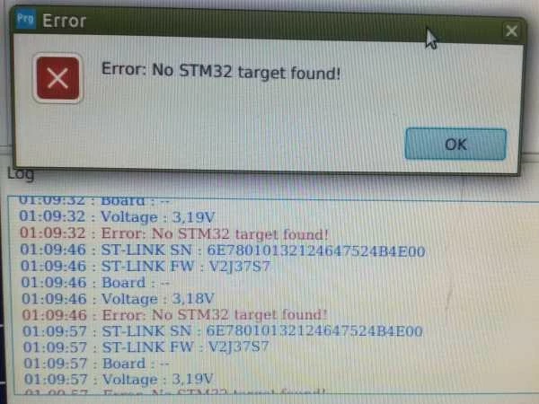

I have experience with several types of classic boards with STM32 microcontrollers (NUCLEO, Blue Pill...) that immediately connect with the stlink-v2 and st-info --probe command showing the characteristics of the controller and after that flashing is successful...

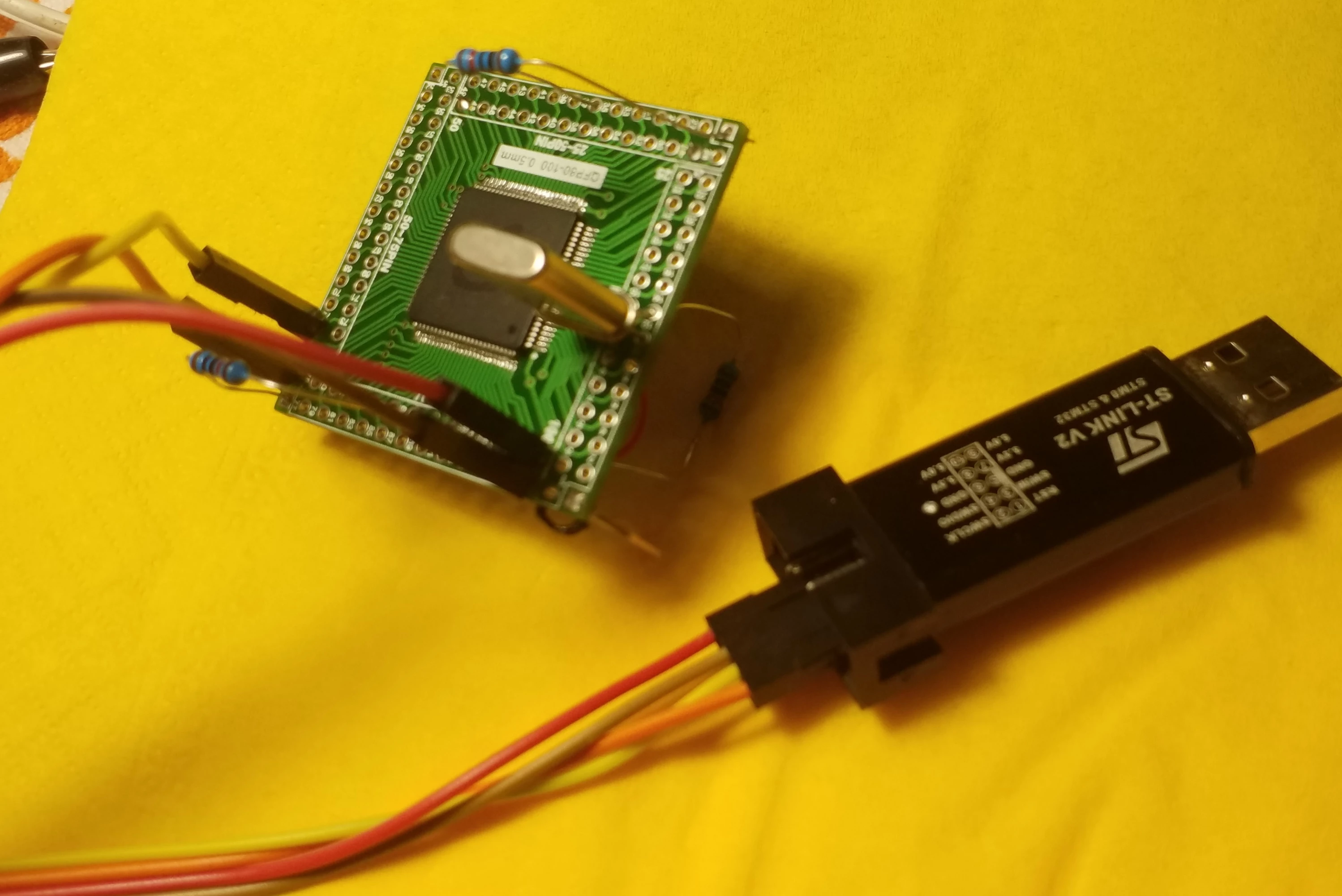

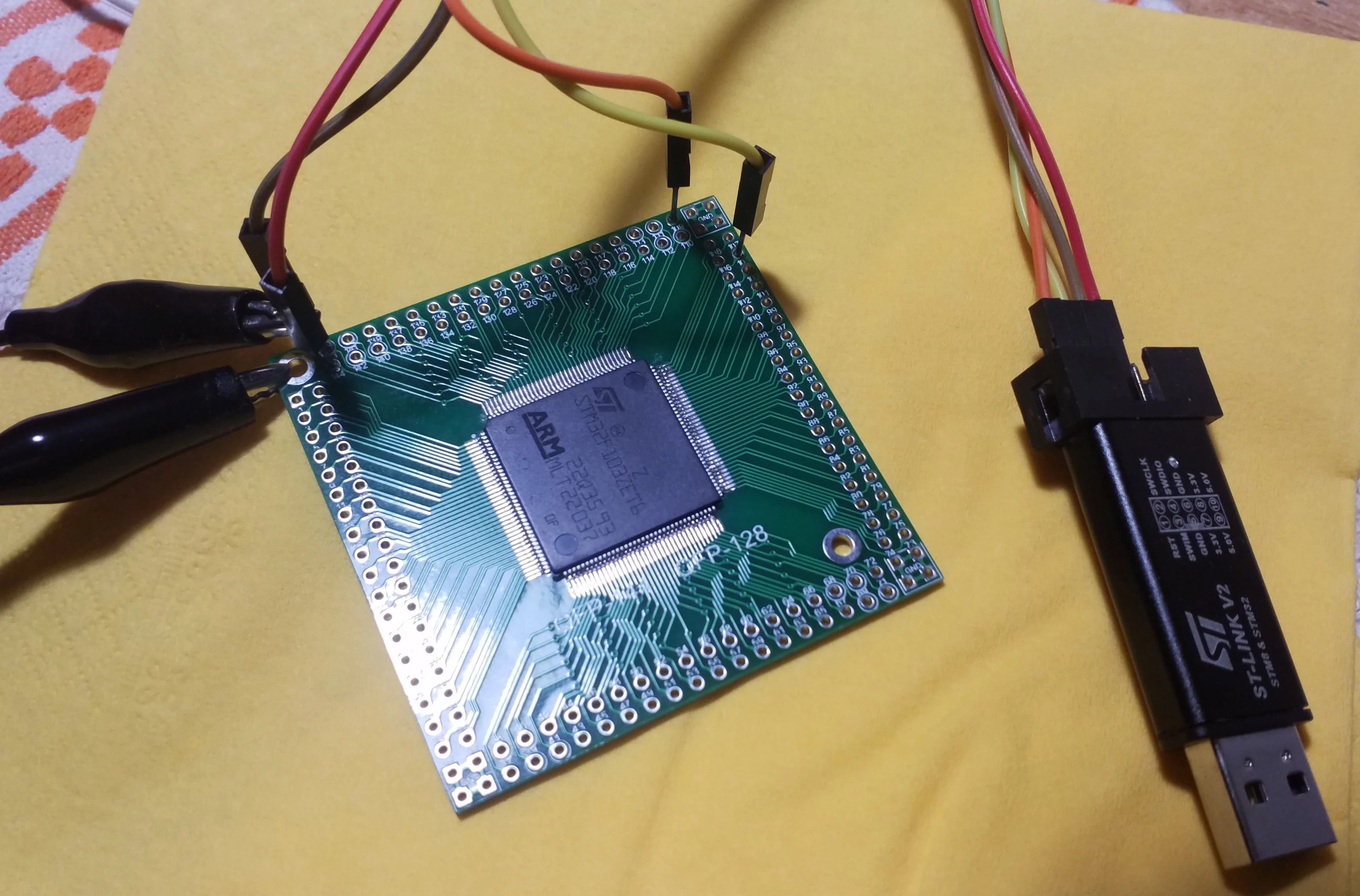

I recently bought the above mentioned two controllers and a boards (LQFP144/100 SMT to DIP Adapter PCB Board) where I soldered them with the necessary capacitors between all the VDD and VSS contacts. I properly connected SWDIO and SWCLK to PA13, PA14 pins, NRST to VDD over 10k resistors even boot0 over 10k resistors to VSS (This is how I noticed on all the schemаtics). There is no way I can read the microcontroller or flash it, although in addition to st-info and st-util, I also used STMCubeProgrammer and a linker on the Linux and Windows systems.
Result:
st-info --probe
Found 1 stlink programmers
 serial:   6e78010132124647524b4e00
 hla-serial: "\x6e\x78\x01\x01\x32\x12\x46\x47\x52\x4b\x4e\x00"
 flash:   0 (pagesize: 0)
 sram:    0
 chipid:   0x0748
On one site I found detailed instructions on how to program the new STM32f103c8t6 for the first time. Nothing special is stated there and I did it all and I don't succeed at all.
I found almost nothing on Google that would help me except for someone to mention somewhere to "Pay special attention to the pull-up resistor on the TDO line", (PB2 ?).
Is there any useful advice or experience?

The problem is solved!
The downside was that I didn’t connect VDDA to VDD because I felt it wasn’t necessary if I didn’t use ADC.
after I connected VDDA to VDD it worked.

Oct 1, 2020 10:41 PM UTC
You should have decoupling capacitors near the chip. You said you soldered them in your post but I don't see them on the boards anywhere. They're supposed to be close to the chip.
Rather than trying to solder this to a breakout board, buying a Nucleo board might be better and more cost efficient.

They are on the other side... 100nF ...
