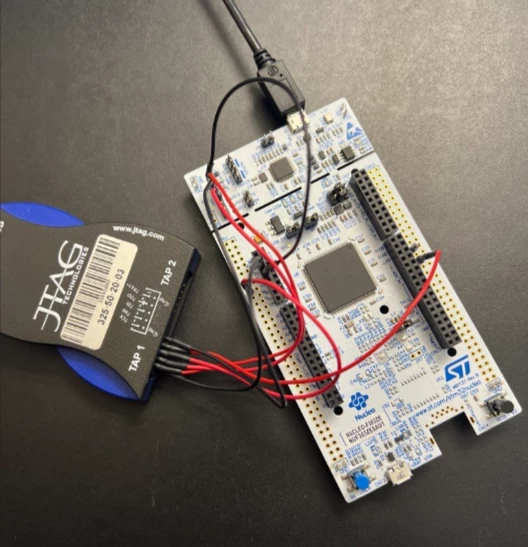

I made a code to readout all the STM32 ADCs. The code works.
I want to run it on my Nucleo-F303ZE with JTAG ProVision, but it dont work.
What did I do wrong?
I connected it like this:
JTAG               NUCLEO
TCK     =>        SWCLK-JTCK (PA14)
TMS     =>        SWDIO-JTMS (PA13)
TDI       =>        JTDI (PA15)
TDO     =>        JTDO (PB3)
TRST   =>        NRST
GND     =>        GND
3.3V      =>        VDD_Target
Thanks for your time

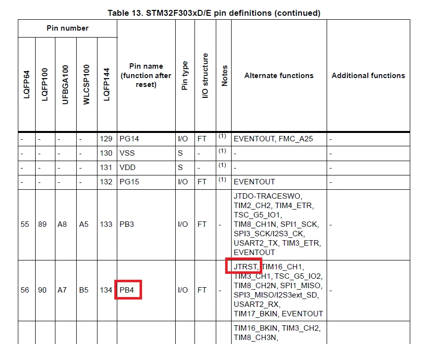

According to datasheet of STM32F303ZE, TRST is on PB4. Could you double check?
B.R.
