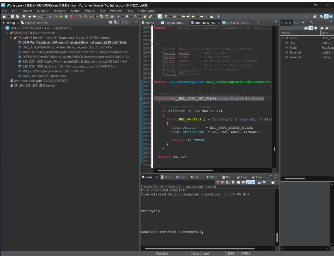

Hello everyone,
I'm facing a perplexing issue with my program getting stuck after a successful upload. The upload process completes without errors (screen remains lit white), but upon running the program, it hangs at  MX_OCTOSPI1_Init() and the screen remains black.
Symptoms:
  • Program hangs indefinitely in the OSPI_WaitFlagStateUntilTimeout function.
  • This occurs during initial program execution, before TouchGFX & FreeRTOS starts.
  • The upload itself is successful (white screen persists).
Background:
This problem recently emerged, and the program was functioning correctly beforehand. I've even tried creating new projects from TouchGFX Designer, but the issue persists.
Request for Assistance:
I believe the culprit might be the MX25LM51245G_AutoPollingMemReady function, which verifies if the NOR Flash memory (MX25LM51245G) is ready for new commands. However, I'm seeking your help to pinpoint the exact cause.
Additional Information:
  • I'd appreciate it if you could provide insights into what might be causing this issue and how to resolve it.
  • Are there any debugging techniques or resources specifically suited for the OSPI_WaitFlagStateUntilTimeout function that you could recommend?

Tesla DeLorean
Guru
May 20, 2024
Make sure to clear out auto/local structures in functions so they don't contain random junk.
Don't have infinite time-outs, other than erase most things should complete in 100's of milliseconds.
Make sure the SystemTick is functioning and counting off time.
Check what state it's waiting for here, and what state it's seeing. Instrument so you can see what's happening in real-time and don't have to fish state out of registers, stack and structures.

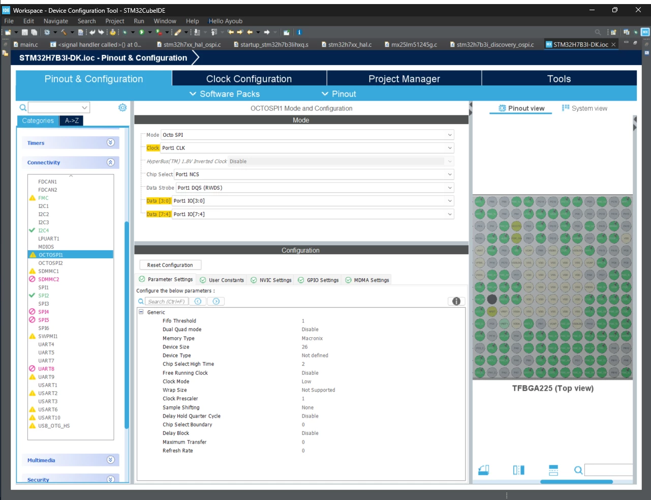

Ayoub_Bnina
May 20, 2024
Hi @KDJEM.1, I have been Following the OCTOSPI (Macronix) pins Configuration corresponding to my STM32H7B3I-DK board and it mentions octospi1 instance on the pins label MB1332 (st.com), While in the AN5050 (st.com) you provided, it mentions that the Macronix is situated on the octospi2 instance. which one should I follow ?
Tesla DeLorean
Guru
May 20, 2024
Ayoub_Bnina
May 20, 2024

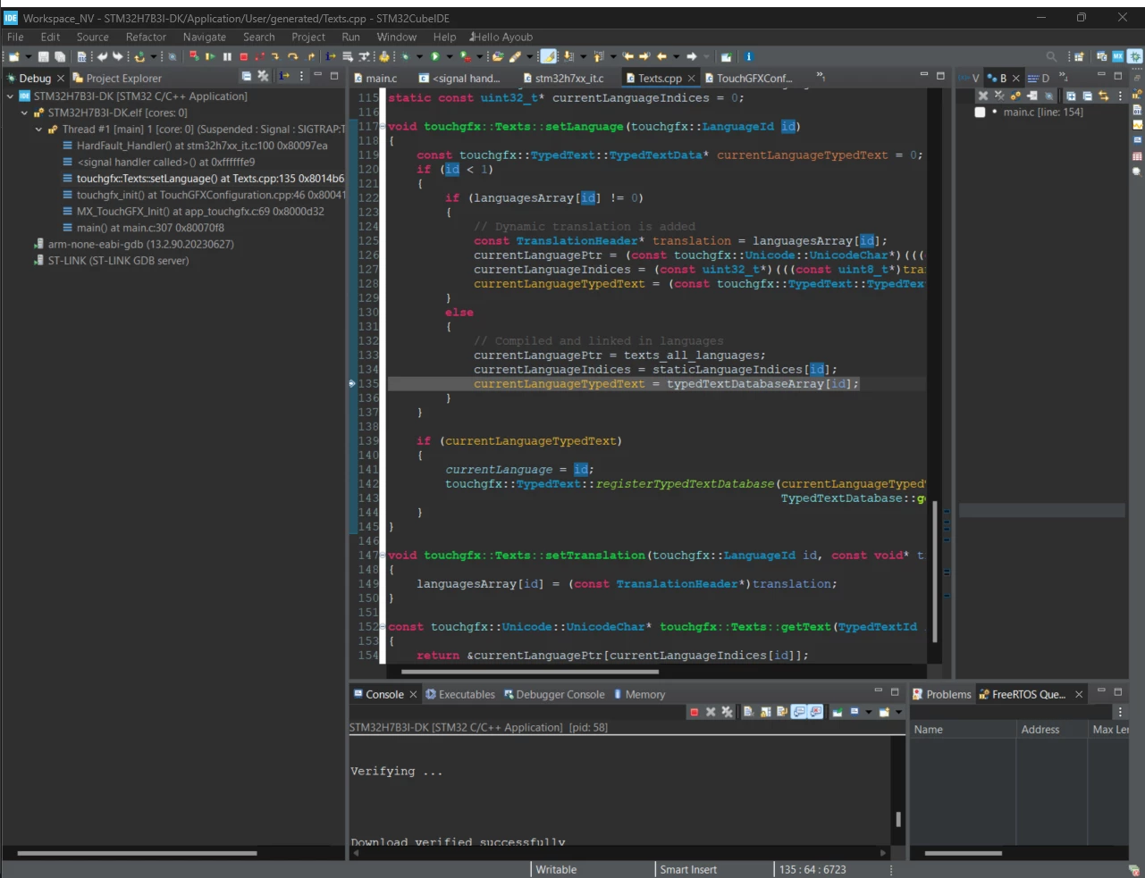

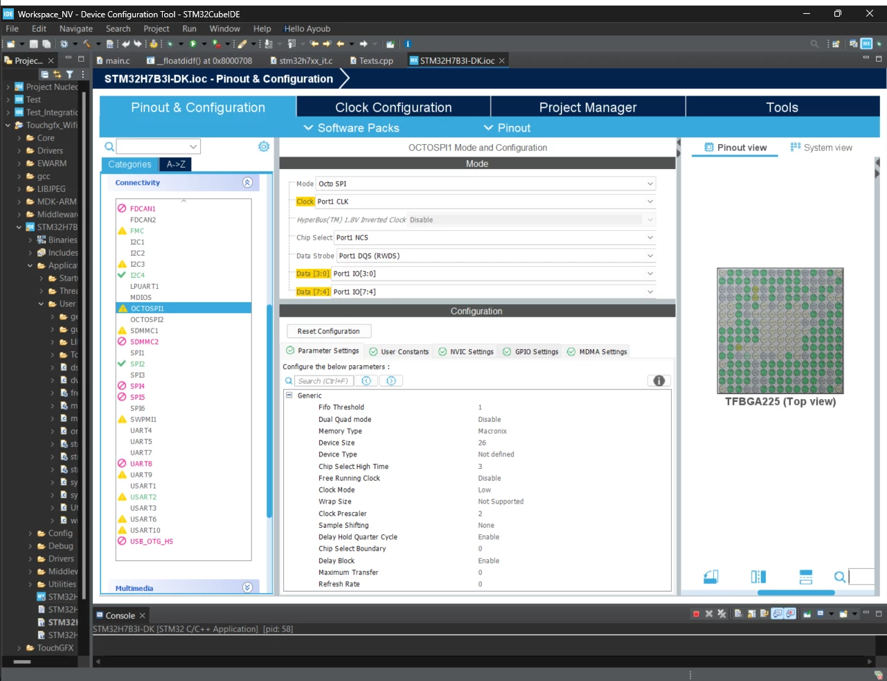

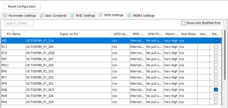

@KDJEM.1 @Tesla DeLorean  This my OCTOSPI Configuration
Now I am encountring an old problem situated in Texts.cpp, The program unable to find typedTextDatabaseArray[id]
I am pretty sure my configuration is right, if not please help me understand the problem. Thank you!

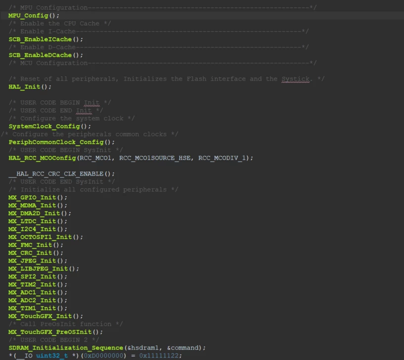

Tesla DeLorean
Guru
May 20, 2024
Pins look correct.
The External Loader typically Memory Maps the device, and does a HAL_OSPI_DeInit() prior to HAL_OSPI_Init() to break it out of that mode of operation, and typically sends a RESET to the memory IC to ensure both sides start from a known operational mode from the outset.
The ordering of your MX_XYZ_Init() functions may also be critical.
Build some of the DK's examples the don't use CubeMX to auto-generate, nor use the RTOS.
