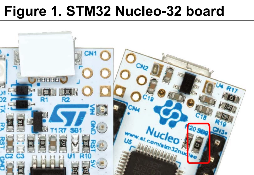

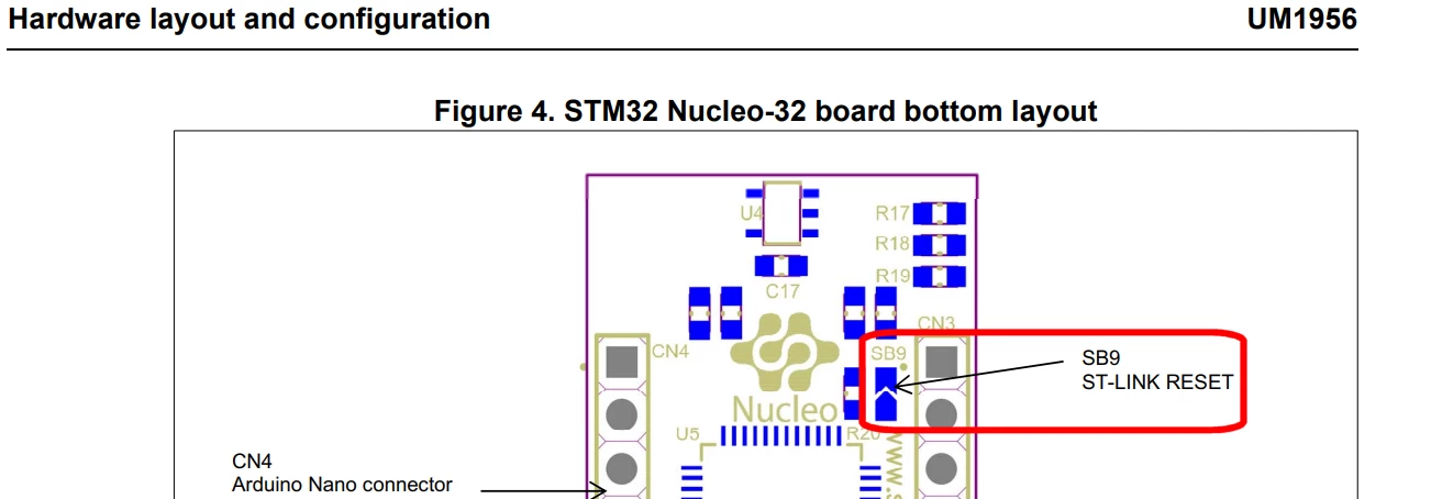

@DavidL_ wrote:
How would I „break“ this link? What exactly does that mean?
It's here:
The photo in the UM shows a zero-ohm resistor fitted:
To break the link, you need to remove that zero-ohm link.
There's no need to be particularly careful with it - you don't need to keep it - so just heat it up with a soldering iron until it comes off.
@mƎALLEm @STTwo-32 I've noted before that this needs to be better documented:
https://community.st.com/t5/stm32-mcus-products/docmentation-of-solder-bridges/m-p/689362
#BreakSolderBridge #SolderBridge #SB
