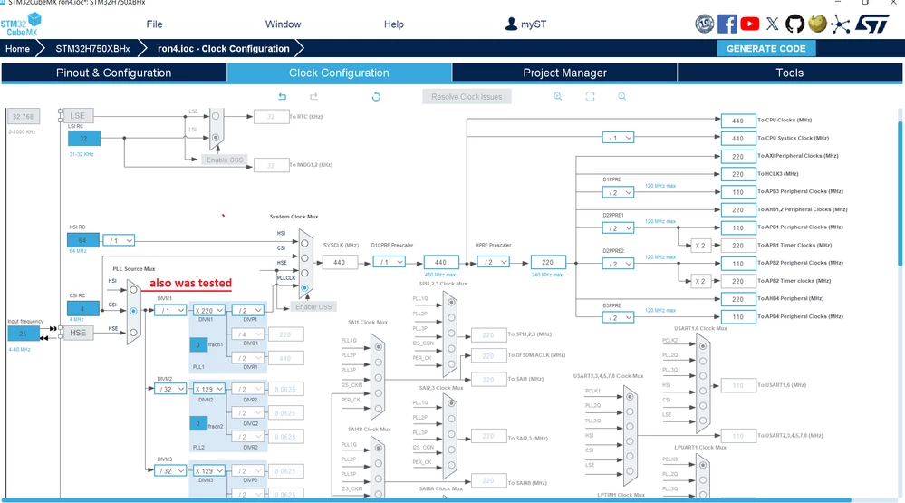

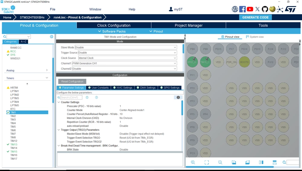

STM32H750 Discovery Kit board, Timer 1, Ch1 (PA8 output)
I used direct access to timer registers as a HAL library and the result was similar.

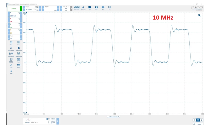

I can receive 10 MHz with direct access to register and   TIM1->PSC = 10;
But when  I set TIM1->PSC = 1 I don’t receive any signal from Timer1 with the next script

I also adjusted A8 for  RCC_MCO_1 and received finally 100 MHz, so I can confirm that my oscilloscope works properly.
And I found here that is possible to make 100 MHz for the timer for STM32H7 via timer and PWM
my settings are here

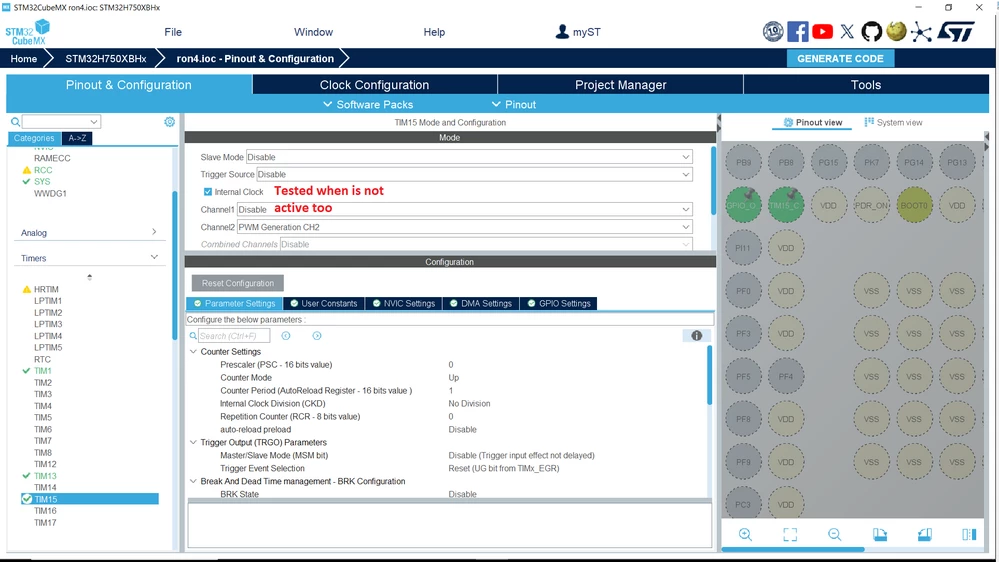

and the same problem for other Timers
as example
HAL_TIM_PWM_Start(&htim15, TIM_CHANNEL_2)

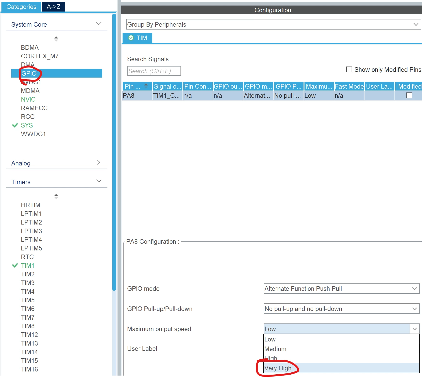

Make sure pins are set to very high frequency. I bet the signal is there but with slow edges. What oscilloscope are you using?
RonilAuthor
August 27, 2024
Hello, thank you, I use PicoScope6404D (500 Mhz)
what do you mean about - "Make sure pins are set to very high frequency. " I use a timer and PWM and made only "Fast Mode" - Enable
TDKBest answer
August 27, 2024
You can change it in the GPIO tab on the left.
RonilAuthor
August 27, 2024
ohhhh, it is works now, thank you so much, my god how did I miss this!!
