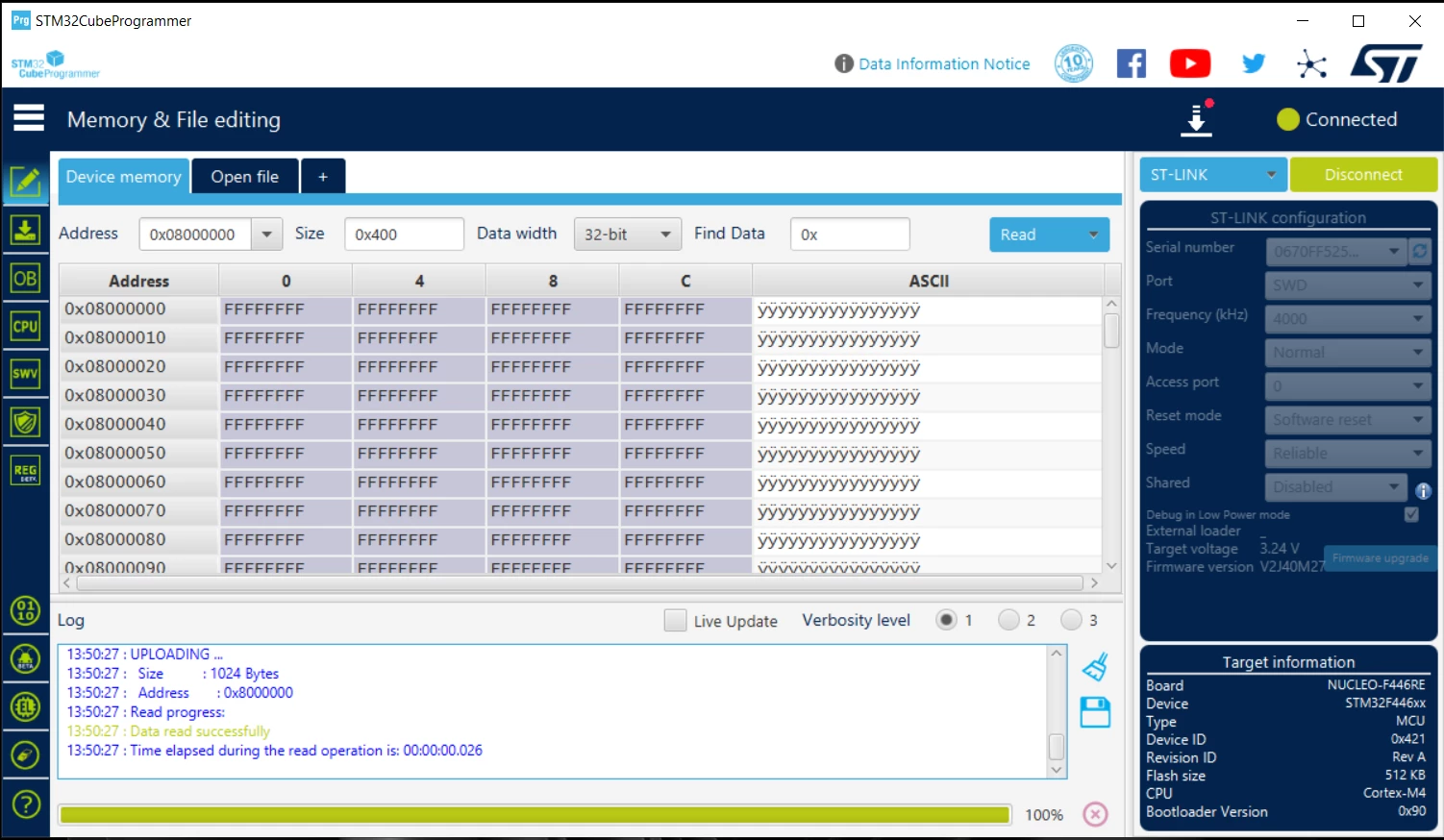

Hello everyone,
I'm having trouble updating the STLINK on my Nucleo F446-RE board. CubeProgrammer allows me to read the microcontroller's memory without any problem, but when I try to update the STLINK firmware, the following happens:

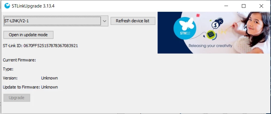

  • It is detected (although it does not provide information about the current firmware or version):

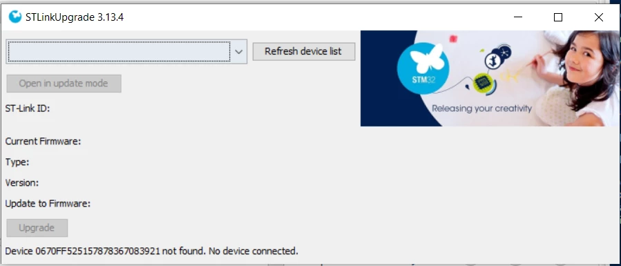

  • However, when I click on "Open in update mode", it becomes "not connected" and I cannot update the firmware. This is a problem because CubeIDE requires me to update the STLINK in order to debug. What could be failing? What am I doing wrong?
