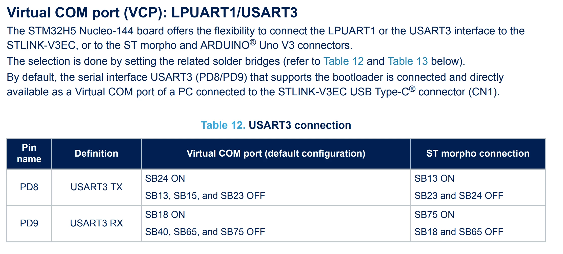

I'm new to STM and I'm trying to use USART to communicate between MCU board and my computer. I'm now using USART2 and CP2102 to translate TTL to USB. And have succeeded. But my goal is to directly use USB-C of STLINK to output serial data, because the user manual of this board just like below shows that the USART3 can directly output to USB-C of STLINK.  But I failed to use only USB to communicate and I don't no why.

Via ZIO connector, simply connect:
USART2_RX (PA3)  to USART3_TX (PD9)
USART2_TX (PD5) to USART3_TX (PD8)
Without disordering anything, you need to ensure that USART3 IOs are not configured to keep them as inputs.

Check the solder bridges mentioned in the documentation. Has anyone played with this board before you?

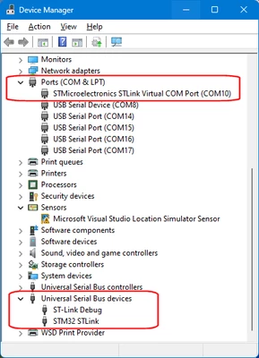

Is the VCP of the board visible on the host side (lsusb or device manager) ?

This board is brand new board, so the solder bridges should be default just like mentioned in the documentation. And sorry that I don't know what is VCP, could you please explain what do you mean by VCP is visible on host side?
Andrew Neil
April 24, 2024
VCP = Virtual COM Port - the USB-to-UART connection appears on the PC as a "virtual" COM port,
When you plug the board in to your host computer, do you see its "COM port" appear?
You haven't said what computer you're using, but on Windows it would appear in Device Manager; eg,
