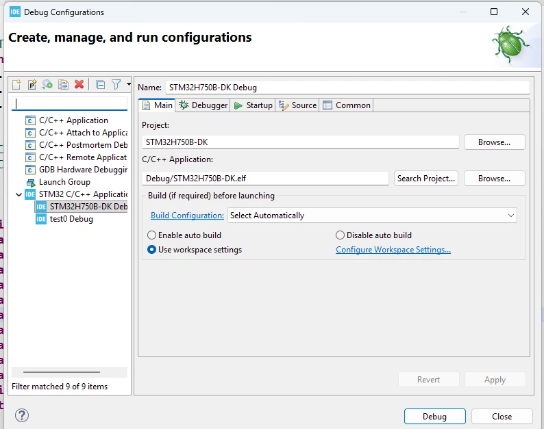

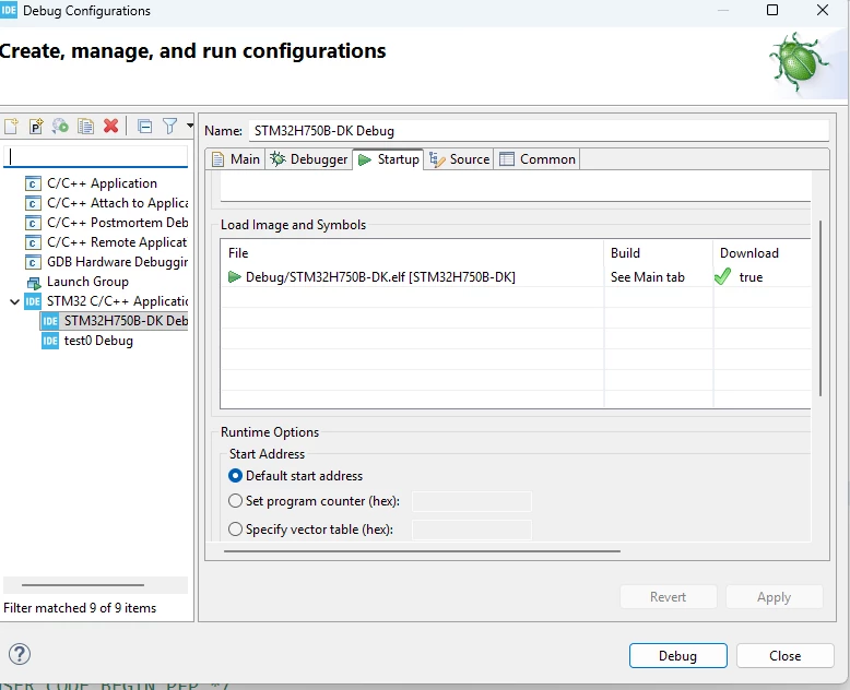

Got a message: " Break at address "0x8001c50" with no debug information available, or outside of program code." and exited. Please help. If you need more info please advise.

Thank you Andrew. Here is mpre info may help troubleshooting:
Build:
19:55:43 **** Incremental Build of configuration Debug for project test0 ****
make -j12 all
arm-none-eabi-size test0.elf
text data bss dec hex filename
51612 208 11584 63404 f7ac test0.elf
Finished building: default.size.stdout
19:55:44 Build Finished. 0 errors, 0 warnings. (took 523ms)
Debug 1:
STMicroelectronics ST-LINK GDB server. Version 7.12.0
Copyright (c) 2025, STMicroelectronics. All rights reserved.
Starting server with the following options:
Persistent Mode : Disabled
Logging Level : 1
Listen Port Number : 61234
Status Refresh Delay : 15s
Verbose Mode : Disabled
SWD Debug : Enabled
InitWhile : Enabled
Waiting for debugger connection...
Debugger connected
Debugger connected
STM32CubeProgrammer v2.21.0
Log output file: C:\Users\asus\AppData\Local\Temp\STM32CubeProgrammer_a13944.log
ST-LINK SN : 004D00213137510C33333639
ST-LINK FW : V3J16M9
Board : STM32H750B-DK
Voltage : 3.28V
SWD freq : 8000 KHz
Connect mode: Under Reset
Reset mode : Hardware reset
Device ID : 0x450
Revision ID : Rev V
Device name : STM32H7xx
Flash size : 128 KBytes
Device type : MCU
Device CPU : Cortex-M7
BL Version : 0x90
Opening and parsing file: ST-LINK_GDB_server_a13944.srec
Memory Programming ...
File : ST-LINK_GDB_server_a13944.srec
Address : 0x90000000
Erasing external memory sectors [0 1]
Erasing memory corresponding to segment 1:
Erasing external memory sectors [16 17]
Download in Progress:
File download complete
Time elapsed during download operation: 00:00:02.733
Verifying...
Time elapsed during verifying operation: 00:00:02.078
Download verified successfully
Shutting down...
Exit.
Feb 9, 2026 10:48 AM UTC
Hello @ksale.1 ,
Try to erase the flash memory again with STM32CubeProgrammer and reprogram the device. Disconnect STM32CubeProgrammer from the target and debug again.
