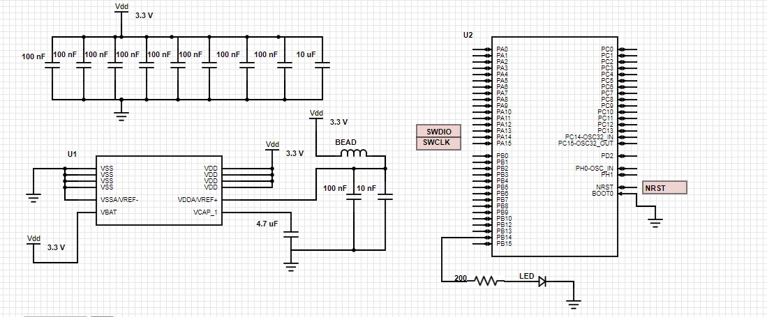

Hardware details: I am using the 3.3V and GND pins from the St-Link v2 for the power for the custom board. I have attached all VSS and VSSA pins to ground. I have attached all VDD and VBAT pins to 3.3V. I ran a 3.3V line to a ferrite bead, which then leads to VDDA. I added a 100 nF and 10 nF to ground for VDDA. I pulled BOOT0 low. I attached NRST to the RST from the St-Link v2 pin. I use a 4.7 uF capacitor for VCAP to ground. I added 2 x 100 nF decoupling capacitors from the 3.3V line to ground for each VDD pin on the chip (a total of 8 caps) and a 10uF capacitor.

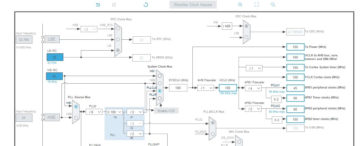

March 10, 2022
Cube's auto generated code uses FLASH_LATENCY_5 in the SystemClock_Config function when i configure for max clock (180 MHz). Going by the datasheet which says that for 180 MHz, use 5 wait states and over-drive ON. I attached a screenshot of the clock config, in case you notice any problems with it.

Not real sure. What is the pedigree of the hardware? Reflow at an PCB assembly company or soldered in an at-home lab with substandard tools? Could be soldering problems. I don't see any issues with the clock setup.

Description otherwise sounds OK, post layout for us to discuss. Also check the connections for potential bad solder joints.

I assume current wouldn't be a problem, since ultimately all the current is coming from a USB port on my laptop, just like with the Nucleo board which has no problems at all. I did continuity tests from the pins of the STM32 to my header pins which were fine, as well as continuity tests between adjacent pins to see if there was any shorting, but it was fine.
I attached a schematic I made of my setup on my breadboard.

1) I do not see Vcap2 on your schematic. Put 2.2uF on both Vcap1 / Vcap2

if someone is still looking for answers.. I had exact same issue on my custom board - could not able to set max clock (180 mhz using HSE + PLL or HSI + PLL), and lower clock freq settings were working but with random hardfaults. Root cause was the missing cap on vcap1 pin (pin 30 on stm32f446re).
