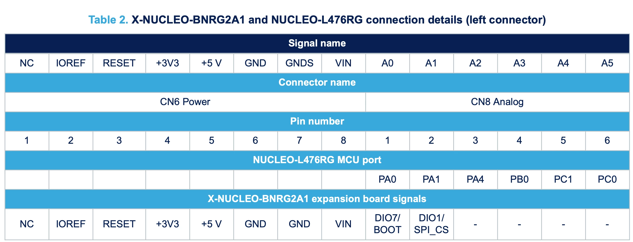

Hello, I am using the NUCLEO-WL55JC2 board with the X-NUCLEO-BNRG2A1 ble extension board. I run the SensorDemo_BLESensor demo code and I can detect my board in the BLE Sensor application In my phone. However, I want to connect a DHT11 temperature sensor but when I connect the VCC pin of the sensor to the +5V or +3V3 on CN6 connector of the extension board I can no longer detect the board in the application.
In the documentation, I see that that the pins are corresponding :
Do you have any idea of what the problem may be?

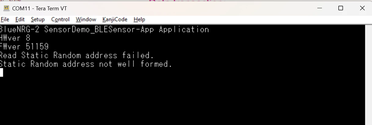

Hello, following your post here, it seems that you have solved the issue and can communicate with the BLE-Module with that board, would you share the configurations that you followed to make it work (Advertising) as I get the "Read Static Random address failed" error due to the configurations.
Thank you
