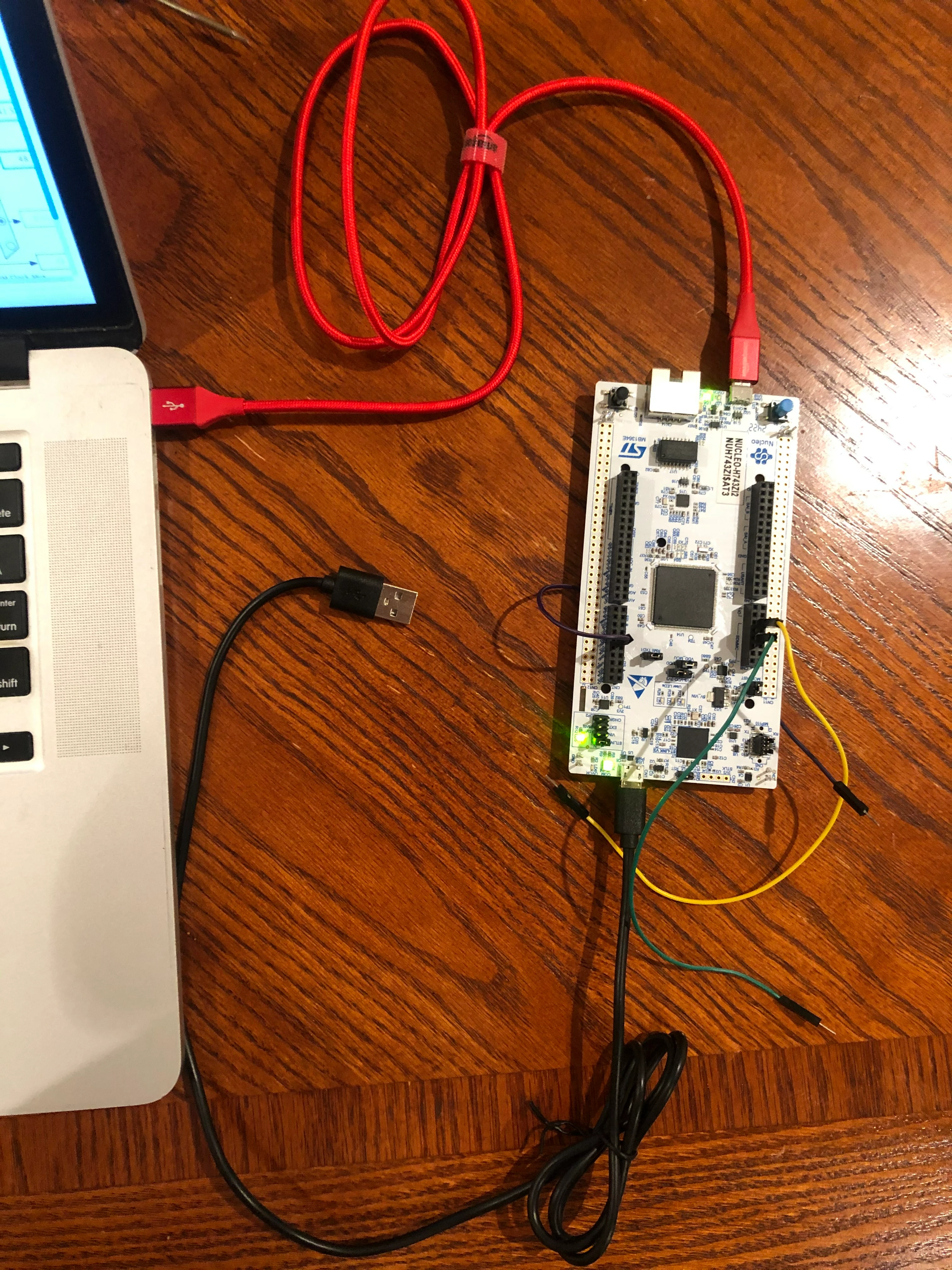

JJ.5
JJ.5Author
Jun 11, 2023 10:16 PM UTC
@pavel A.​ @Nikita91​ @FLeon.4​ @Rodo​
I found the board NUCLEO-H743ZI2 can be powered by the user usb automatically.
First, I need to connect both ST-Link USB and User USB to two USB ports.
Then, I can just unplug the ST-Link USB and the board is still running.
Not sure why.
I also attached a image below. As you can see, the LED lights are on and ST-Link usb(black) is unplugged
The trick is let ST-Link USB power the board first then switch to User USB by unpluging the ST-Link USB.
I'm not sure this functionality is mentioned on the user manual.
Is there a way to make the board boot up from User USB?
Thanks!
