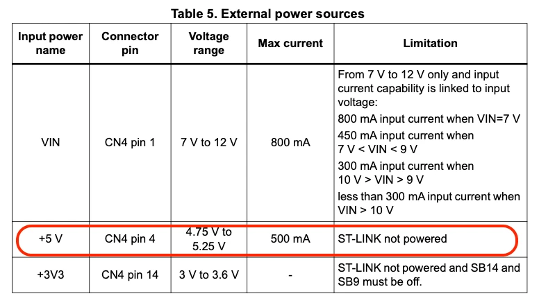

@Andrew Neil thanks for prompt reply.
According to the documentation, Nucleo can be powered from source which gives 3-3,6V or 4,75-5,25V. The li-pol battery has 3,7-4,2V. What would you suggest to do, to power the Nucleo from the li-po battery?

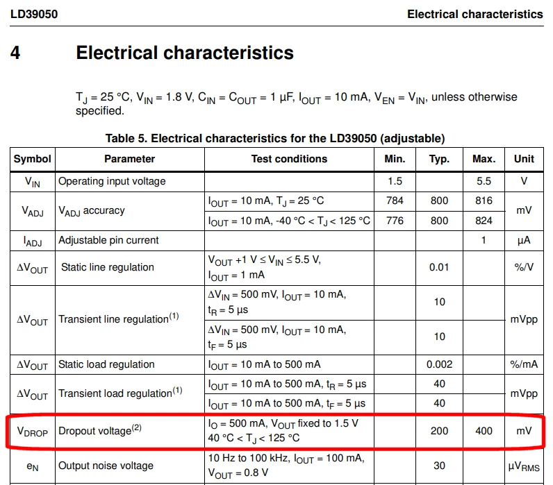

Thank you for forcing me to learn something :)
It looks that +5V goes to LD39050PU33R, which has operating input voltage 1,5-5,5 V. That means that indeed I can power Nucleo from lipo battery via this PIN.
This is great news, because I was afraid that I will need to add some component between lipo and Nucleo.
Last question: is it ok, that the battery will be connected to Nuclea and AEM10941?
Andrew Neil
Mar 28, 2025 3:26 PM UTC
More important would be the dropout voltage - ie, can it maintain 3.3V output regulation when the input is only 3.7V.
(that might not matter - so long as the output doesn't drop below the minimum operating voltage of the STM32L432KC, and/or anything else on the board)
PS:
It's 400mV max - so you should be OK:
https://www.st.com/resource/en/datasheet/ld39050.pdf#page=7

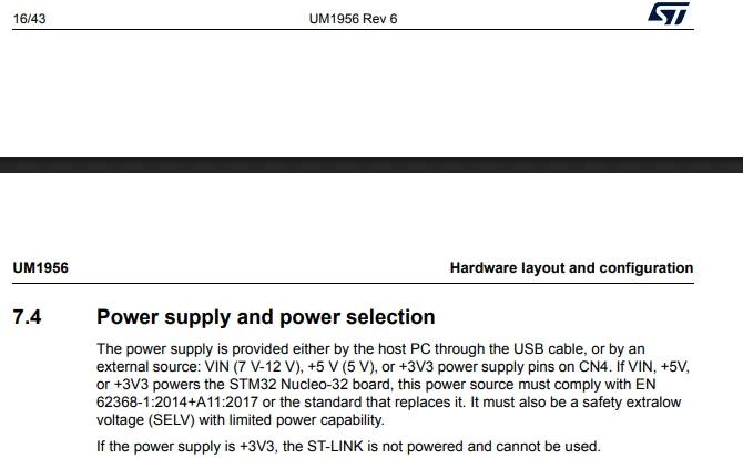

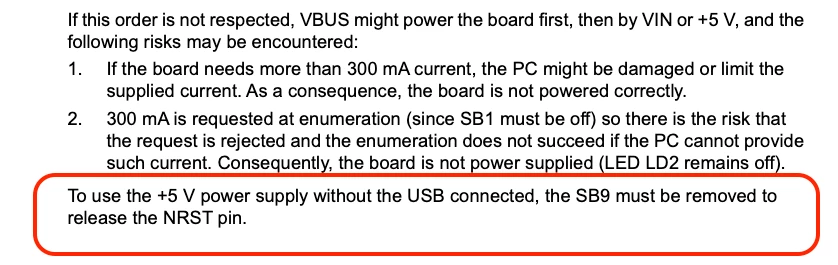

One more question: does the SB9 need to be removed when connecting battery to +5V (and USB not connected)?
In manual, in the table it does not say that it needs to be removed.
However in other place of the manual it says that it must be removed.
Looking at the schematics, I think that when SB9 is ON and USB not connected, then reset will be permanently ON. But I'm not sure about that.
Peter BENSCH
Apr 8, 2025 6:07 PM UTC
If you want to supply the NUCLEO-L432KC exclusively via +5V (CN4.4), the embedded ST-LINK receives no supply voltage due to D3 and D4, so that its output PB0 (T_NRST) is undefined and is usually read as low. For this reason, the second sentence you framed recommends removing SB9 so as not to block the target.
