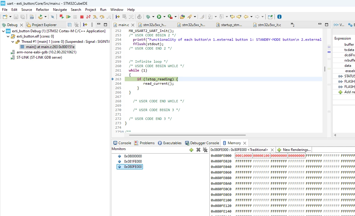

But when trying to overwrite data after erasing it is not happening, when observed in debug state, the memory sector is not under write protection, when erase function HAL_FLASHEx_Erase(&eraseInitStruct, &pageError)  is called it returns HAL_OK but when memory segment observed, the data in that memory segment did not become all 1's, later when HAL_FLASH_Program(FLASH_TYPEPROGRAM_QUADWORD, STATUS_ARRAY_ADDRESS, (uint32_t)data_quadword) is called not data change is observed.
I've attached the main.c file below. Let me know where I'm going wrong.

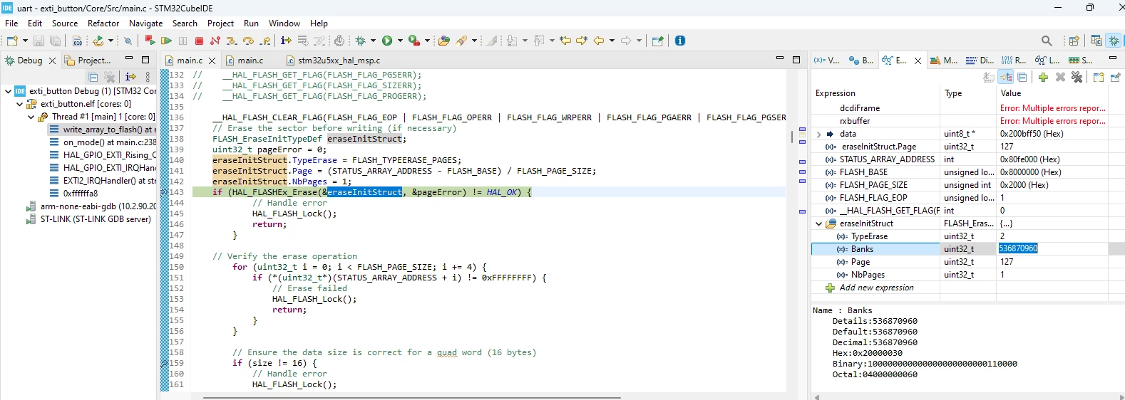

Jan 31, 2025 1:44 PM UTC
Show the content of eraseInitStruct when HAL_FLASHEx_Erase is called.
Show the value of STATUS_ARRAY_ADDRESS.

Jan 31, 2025 1:52 PM UTC
Hi @TDK
I have attached the ss above after doing stepover also the contents of eraseInitStruct didn't change.
TDKBest answer
Jan 31, 2025 2:14 PM UTC
The Banks value is invalid. Probably should be FLASH_BANK_1.
