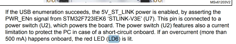

LD6 shows overcurrent on the track ‘5V_USB_CHGR’, i.e. the supply voltage of 5V coming from the USB micro socket. This means that more than the permitted 500mA is definitely flowing there.

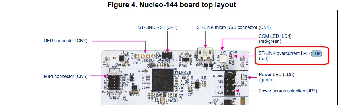

I don't see an over-voltage LED. Do you mean the over-current LED - LD6 ?
https://www.st.com/resource/en/user_manual/um2407-stm32h7-nucleo144-boards-mb1364-stmicroelectronics.pdf#page=12
The User Manual says this indicates over-current on the USB connection to the ST-Link:
As @Peter BENSCH said, you need to show a schematic of your full setup.

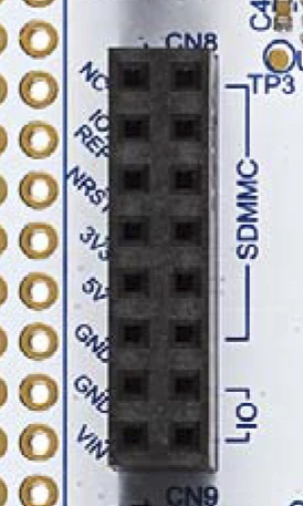

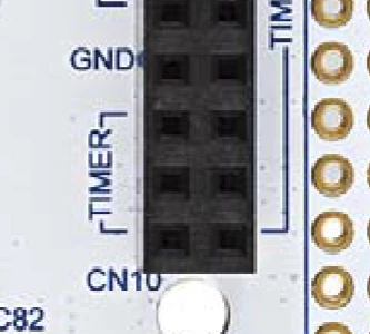

During testing with our other NUCLEO-H753 board (exact same model), we probed Vin and GND with the voltage setting on our multimeter (Sonel CMP-2000), below are the exact pins:
GND on CN10
Vin on CN8
The board was being supplied wtih 12V via an external supply (PS-303S Single Channel DC Power Supply).

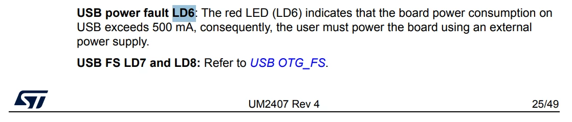

Immediately following this, the overcurrent LED turned on on this board as well. Having looked again at the datasheet, at the end of section 6.4.1 (Power supply input from STLINK-V3E USB connector), the when the overcurrent LED turns on, the board should still be able to operate when powered externally as specified, when we tried this again only LD5 turned on on the board. It was flickering and very dim. Futher U12 is only overheating when powered via PC, not when powered using Vin.
USB PWR used for PC connection
What can we do to fix the overcurrent issue? Thank you again for your help and advice.
