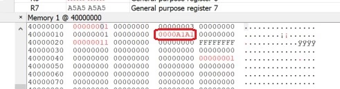

Timer 2 regs. This changes from 0x00008181, 0x00009191, and 0x0000a1a1 for this issue. It's CCMR1 when in input capture mode.
Thanks for the help!

All this looks exactly as expected.
Well, that's then strange indeed, and if the value of CCMR1 register is the only thing which changes between the cases, don't know the reason for this behaviour...
