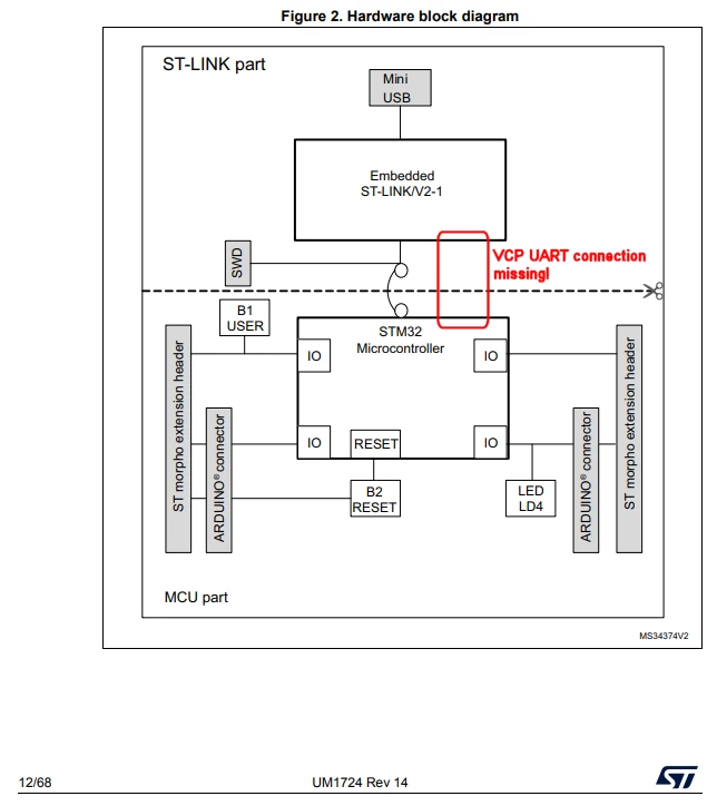

Also UM1724 for the Nucleo-64s:

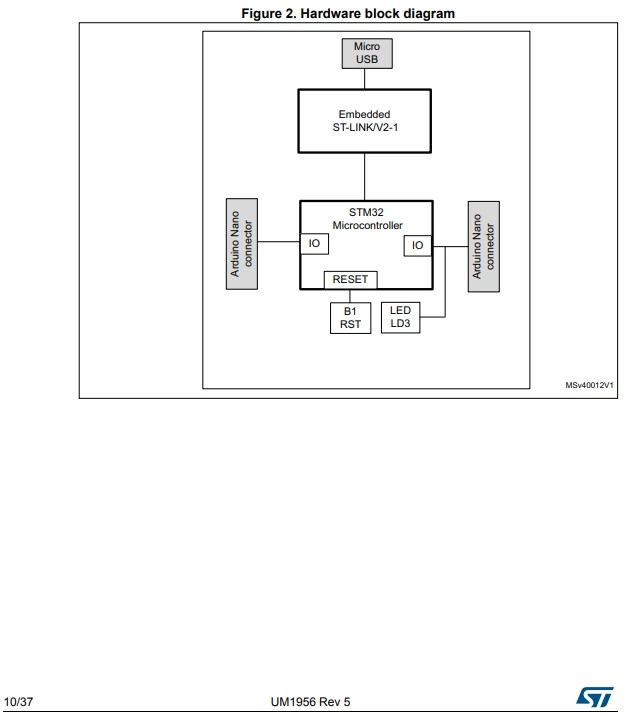

UM1956 (Nucleo-32) just doesn't label the connection at all:
mƎALLEm
Technical Moderator
February 28, 2024
Reported also for UM1956 and UM1724

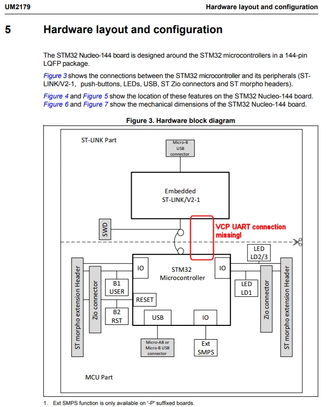

Probably also worth a general check on Discovery and other boards ...

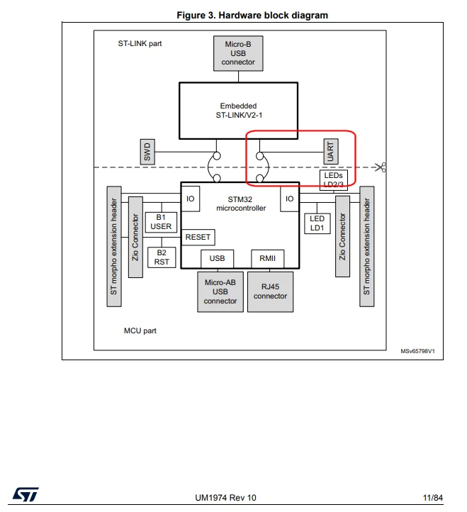

But UM1974 for Nucleo-144 boards (MB1137) does show it!
