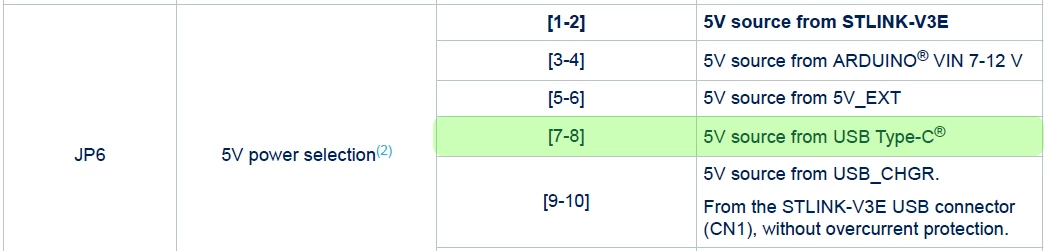

First step: I move the Nucleo from ST-LINK to Segger J-Link, by following this from the Nucleo user manual UM2861
  • move JP6 on pins 7-8, so I power the Nucleo from USB-C

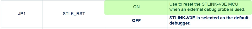

  • set JP1

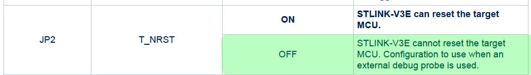

  • unset JP2
All of this works fine, I can upload binary to the board and debug step by step from IAR Workbench, no problem.

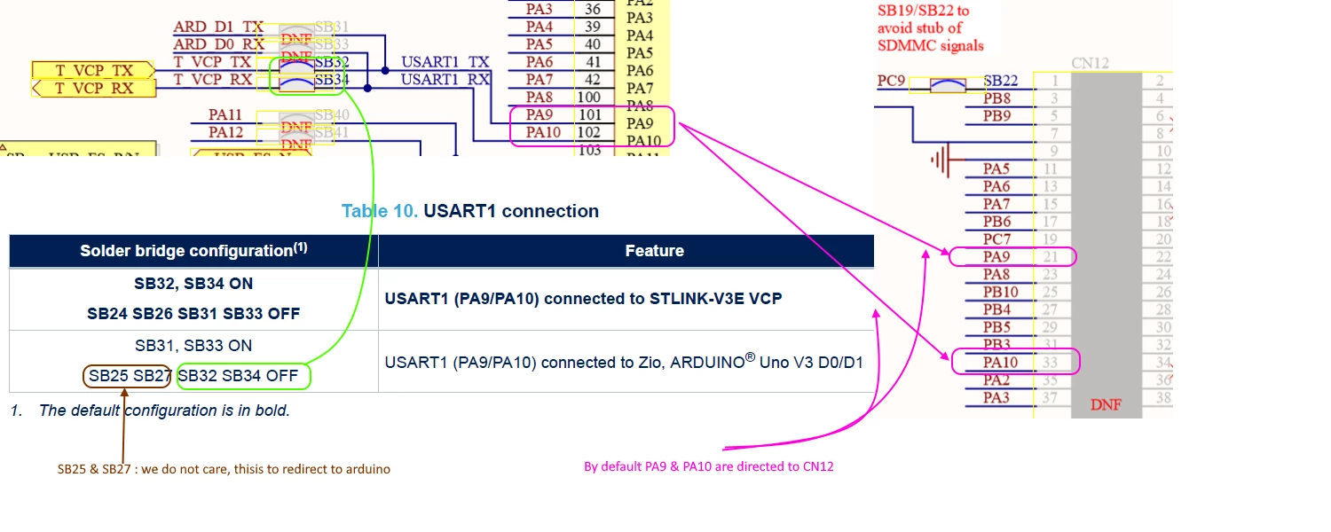

Second step: I want to get rid of the VCP mounted by ST-LINK and directly use USART1 on CN12 connector, that is I need PA9 (TX) & PA10 (RX) + a gnd on this connector and on this connector I wire a FTDI USB-RS232 cable.
  • remove solder bridge SB32 and SB34 : no more connection to ST-LINK
PA9 & PA10 are already available on CN12, nothing to do (note: adding SB31 and SB33 are needed if you want to redirect USART1 to a Arduino. Not my case)

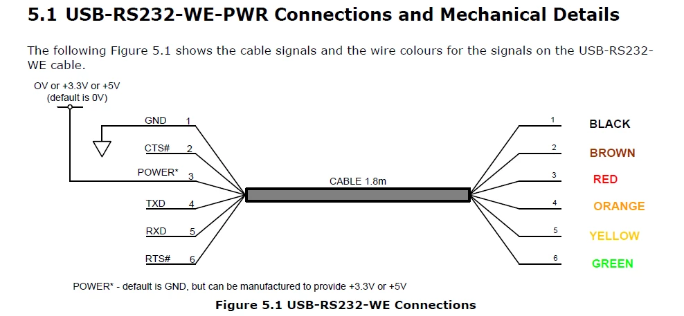

I wire the FTDI as per the manual: I'm only interested in the MCU TX (PA9) so I only wire yellow (TX of the board to RX of the FTDI) and black:
When I power the setup, a VCP is available, no problem:

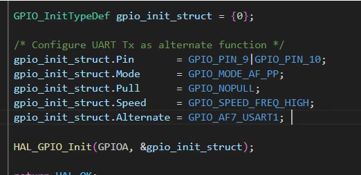

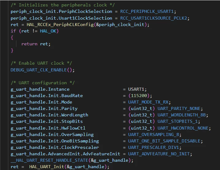

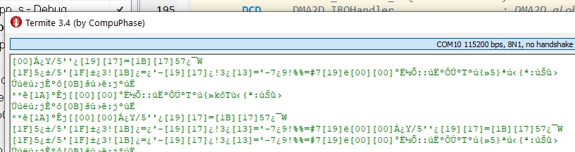

Now, I execute my app, but the only thing I receive on my terminal emulator is garbage (I'm supposed to receive a welcome message readable for a human). I double checked terminal configuration: good speed, size, parity and stop, no flow control, all is good.
I checked million times my gpio and usart configuration, I cannot figure what to do:
The only hardware issue I can see is that without ST-LINK there is potentially a floating signal because of this:
gpio_init_struct.Pull = GPIO_NOPULL;
So I tried both:
gpio_init_struct.Pull = GPIO_PULLUP;
and
gpio_init_struct.Pull = GPIO_PULLDOWN;
without more success.
Also, since I'm not very good at hardware, I also tried to move from "alternate push pull" for the GPIO to "alternate open drain": in this case the FTDI cable receive nothing at all.
I'm lost here, and do not know what to check for the USART communication part. My fellow hardware guy is not available these days, I'll have to wait.
If you have any idea on what is missing from hardware point of view on the Nucleo, if something may have an influence on the TX signal, I'm all ears.

The problem is fixed: Unfortunately I was using the wrong FTDI cable. I used one that needs RS-232 levels where obviously it's TTL that goes out of the MCU. Once I used a good TTL/USB cable, everything is working fine.
