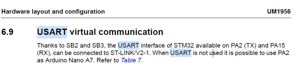

a1rWAXTAAuthor
Jun 26, 2024 4:31 PM UTC
I stumbled upon something in the User Manual (UM1956)
I am confused now. Why in alternate function table, it is shown that PA3 can be mapped to USART_RX but here is written that PA15 is connected to ST-LINK. What does it mean? What exactly is ST-LINK in that case?

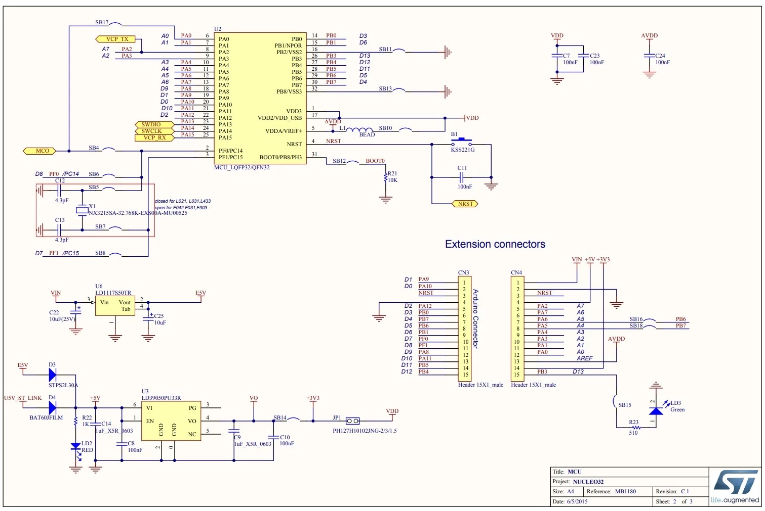

Tesla DeLorean
Guru
Jun 26, 2024 4:44 PM UTC
The Alternate Function tables list a lot of different options, the issue is picking one which is actually board appropriate, which depends on how it's physically wired.
https://www.st.com/en/evaluation-tools/nucleo-f303k8.html#cad-resources
https://www.st.com/resource/en/schematic_pack/nucleo-32pins_sch.zip
PA3 is exposed as an Analogue Input on the CN4 connector
a1rWAXTAAuthor
Jun 26, 2024 5:42 PM UTC
Could you please explain me this schematic? What is the part U2 and what is Extension connectors? PAx are MCU's pins and they can be assigned to various alternate functions but I'm limited to those what board realize, right? A3, D3 etc. mean analog pin, and digital pin (in/out) respectively, don't they? And hence I can assign (in cubemx) only those functions pointed on the schematic, even though cube allows me to assign other functions (for whatever reason?). For example PA15 can be only mapped to usart, and can't be mapped to general purpose input and PA3 is analog input/output? Do I understand it correct?
