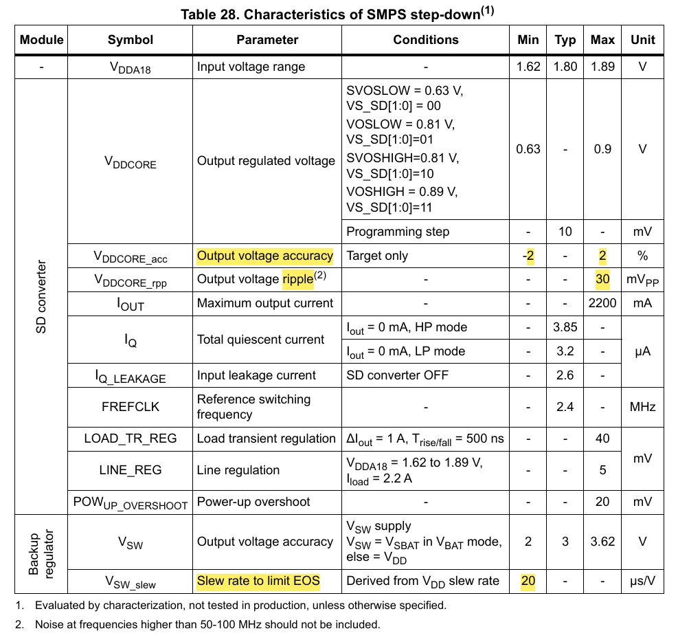

Q2/whether there are any known contention/stress concerns during reset/boot when internal SMPS is enabled by default
A2/ You can refer to RM0468 / 13.4.1 System supply startup and AN6000-How to build the discrete power supply for STM32N6 MCUs
The main concern is not contention between two regulators both driving VDDCORE at the same time, but rather:
  • who is expected to be driving VDDCORE during startup, and
  • whether the external regulator is compatible with the ROM-defined startup sequence while SDEN is still at its reset value.

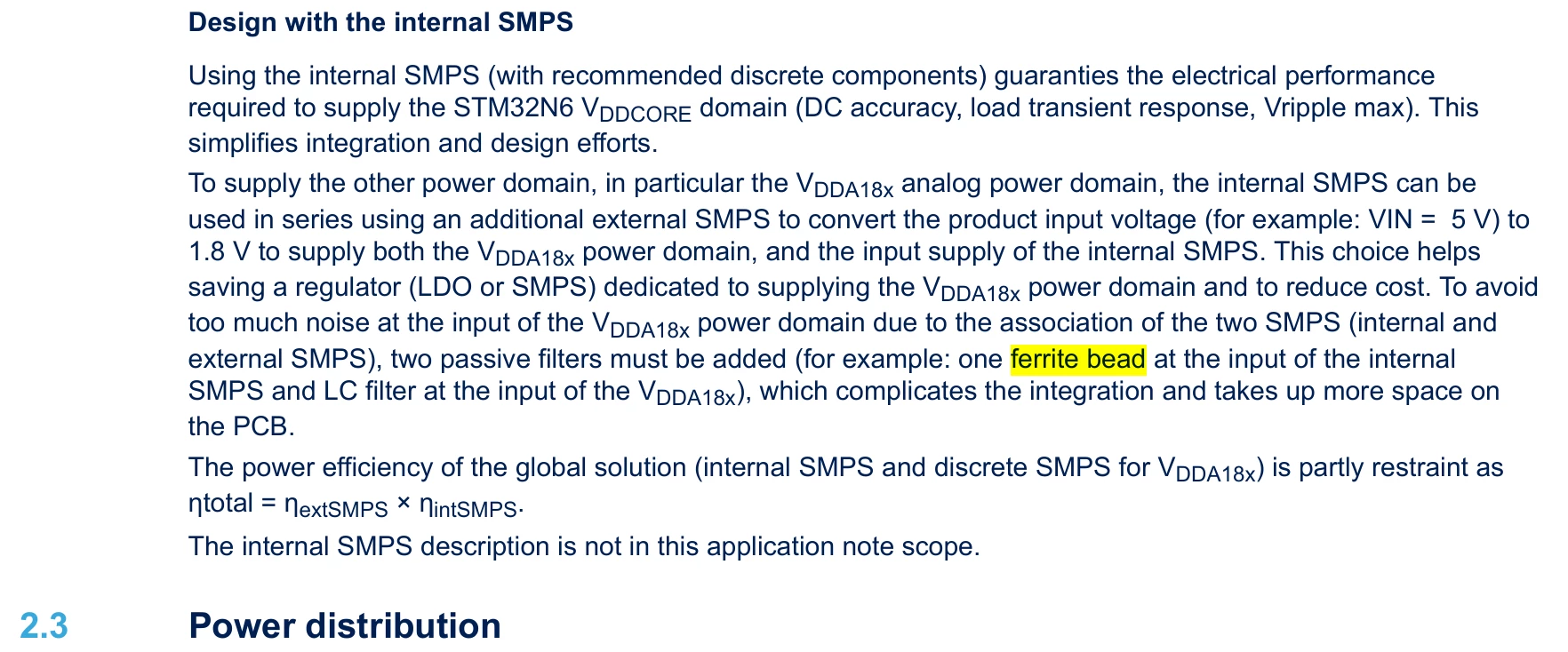

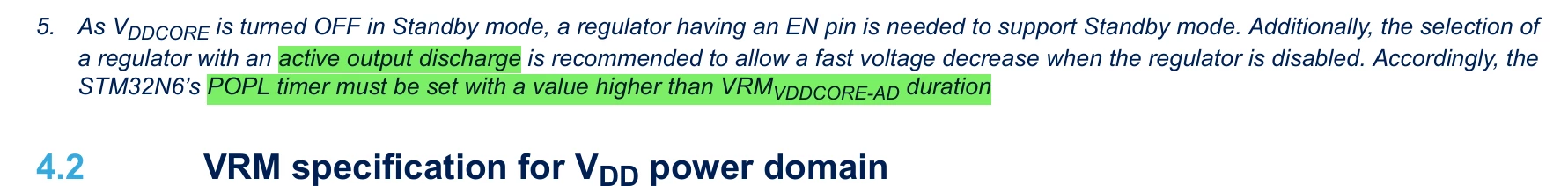

A4/ Protections measures are mostly implicit in AN6000:
  1. Provide voltage input protection on VIN. Front end protection is application specific and should be added at the board level.
  2. Use regulator with EN pin, active output discharge and ability to support 2 output voltages for DVFS:
  3. Ensure the regulator meets STM32N6 electrical limits provided in datasheet.
  4. Add active discharge on VDDCORE. The regulator must pull VDDCORE down fast enough when disabled.
  5. If using monolithic external SMPS with DVFS, choose the feedback-switch MOSFET carefully. See section 5.1.2 Electrical parameters for Q1 MOSFET selection in AN6000
  6. Add passive filtering where needed
