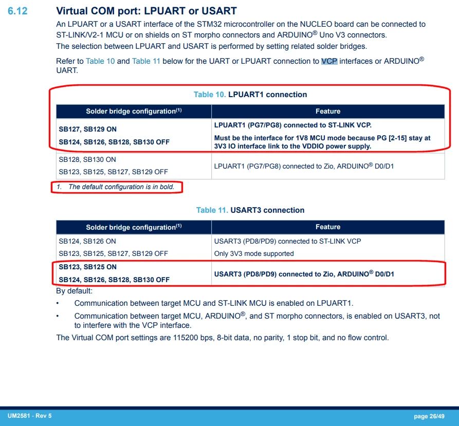

I'm having an issue with connecting my Nucleo board STM32L552ZE-Q via USART3 to both a terminal and SerialPort. I configured the timer and USART3, but I'm not getting any output on the terminal or in SerialPlot. I’m not sure where the error might be. Can anyone provide guidance or troubleshooting steps?

PS:
Note that, by default, USART3 is not connected to the ST-Link's Virtual COM Port:
https://www.st.com/resource/en/user_manual/um2581-stm32l5-nucleo144-board-mb1361-stmicroelectronics.pdf#page=26

I need to configure the UART on my Nucleo board to cyclically send data through its virtual serial port.
Then you need to use LPUART1 - see the PS to my previous post.
