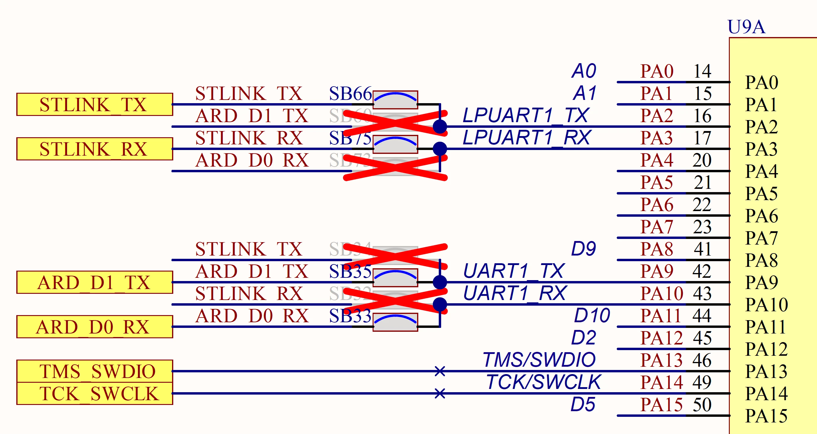

I am using the Nucleo-L433RC-P board and want to use LPUART RX on pin PA3.
But the schematic shows that pin PA3 is used for STLINK_RX.  What is STLINK_RX / STLINK_TX used for ?
Can I remove SB75 to access the pin or would this stop STLINK from working ?

STLINK_RX / STLINK_TX are used for serial communication with a host via the ST-LINK USB connection (virtual COM port). If you don't need that, you are free to use these pins for other purposes.
not the debug function, only the serial comm.

Thank you, so I can flash and debug without the STLINK_RX / STLINK_TX then?

Yes, it's just a comms link for debugging via the VCP, connecting to an STM32L433 UART. On the NUCLEO-64 designs this often conflicts/shares with the Arduino D0/D1 shield connection.
One could use the PB3/SWO for Serial Wire Viewer (SWV)
The programming via JTAG/SWD is via the SWDIO/SWCLK connection.
